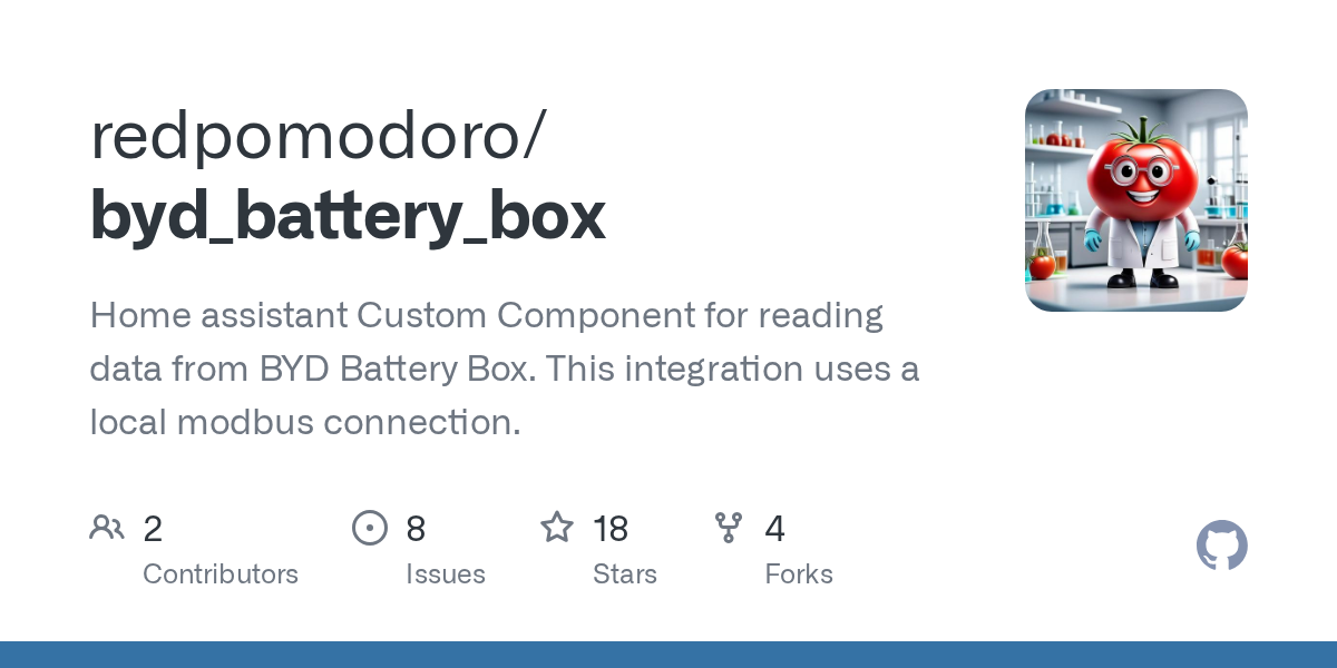

There’s a couple of workarounds
this one if you want to stay on the HA side
that one if you realised things do go wrong in terms of boths SOCs do drift away from each other, Cellvoltages differ a lot and similar effects. This is merely a damn good replacement to the Be Connect Plus app available from BYD. It offers a way better graphical representation, the ability to create logfiles and trace through the recorded period again with an even better graphical representation, and since a while the author of that tool added MQTT publishing which allows to simply publish them to the MQTT broker available as an addon for HA. With the benefit one mustn’t import everything, so one’s not endiing up with hundreds of entites.
Of couse this tool does require an extra hardware either linux or windows where it runs 24/7. Ideal if you own a NAS or have pi running 24/7 for lets say pihole or something like that.
