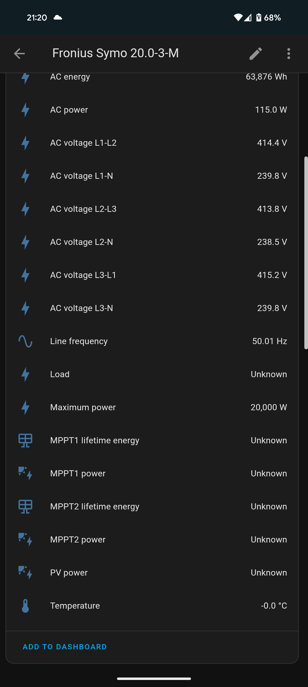

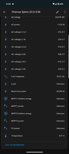

Hi
First of all: thanks for your work!
I got my Fronius Symo Advanced installed this week.
I was hoping that I could use your integration to monitor the two MPP trackers (north/south). The values aren’t really relevant, but they are still interesting for my curiosity :wink:
I can read both values in the Fronius solarweb portal. I would also like to have them in my HA.
Is there a chance that you can also optimize your extension for the Symo? Or does anyone know of another option?

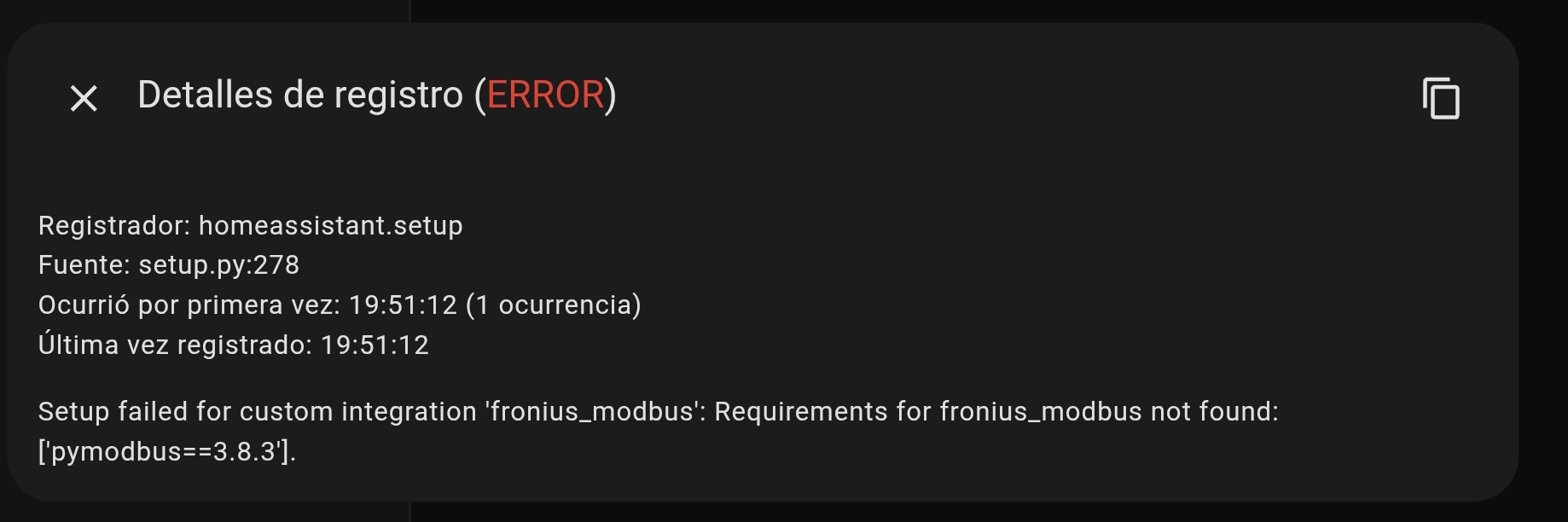

Hello
I updated today to 2025.8.2
And updated pyton scripts pro to de latest version.
And the fronius modbus stop working.
I dont konw if the problem was ha update or python
The error is this:
EDIT:
I think the problem is ha update 2025.8.2 that includes this change:
And Maybe fronius modbus check the pymodus versión as old versión??
