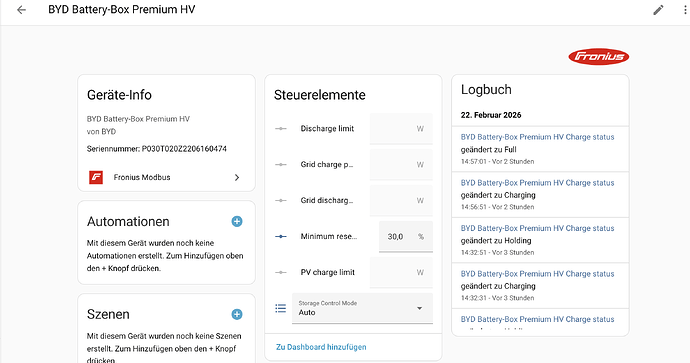

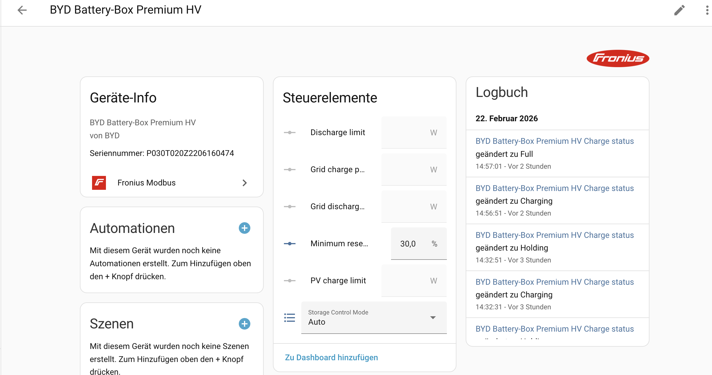

Thanks a lot. I have installed everything but I have only 2 writable fields for my GEN24. Is this normal?
If I change the minimum resevere, the field in the fronius web interface does not change. Any idea?

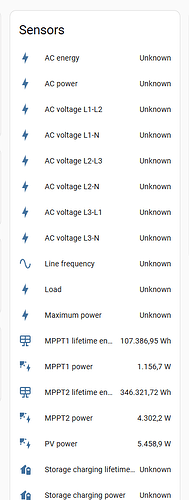

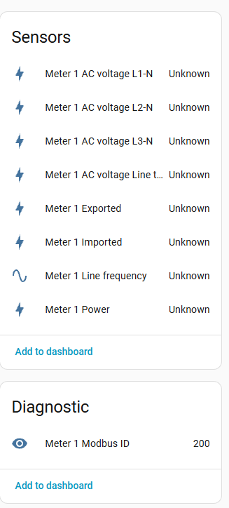

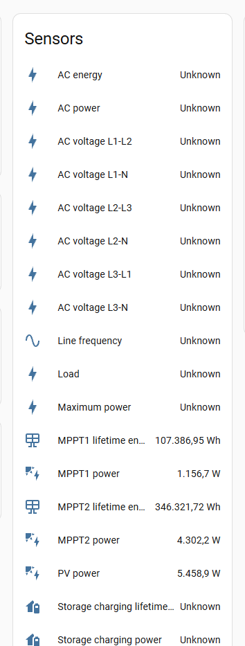

I have a Fronius Verto 15.0
I have downloaded and installed the Integration via HACS.
After trying to enable it it failed as I have not enabled Modbus on the Inverter.

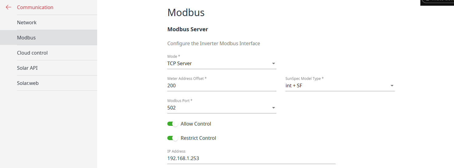

After that I enabled it:
The restricted IP is my Home Assistant.
After that I was able to activate the Integration but most of the sensors are "unavailable"

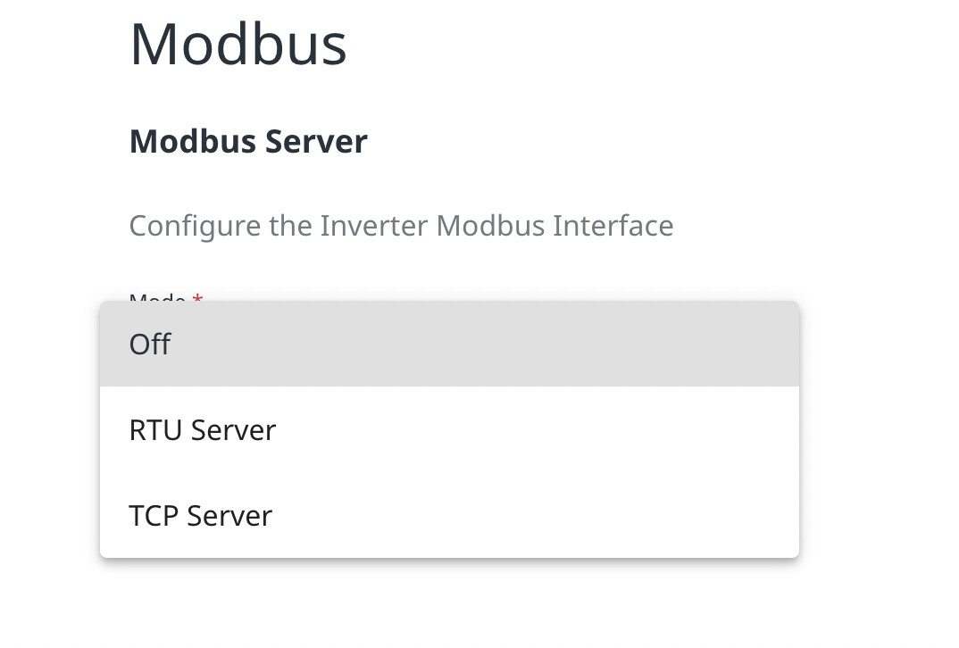

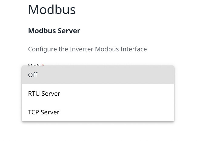

From the Doc I need to configure Mod BUS Client, but I have only the Server Option...
switched to GitHub - callifo/fronius_modbus: Home assistant Custom Component for reading data from Fronius Gen24 Inverter and connected smart meters and battery storage through modbus TCP. · GitHub
now it is working.
