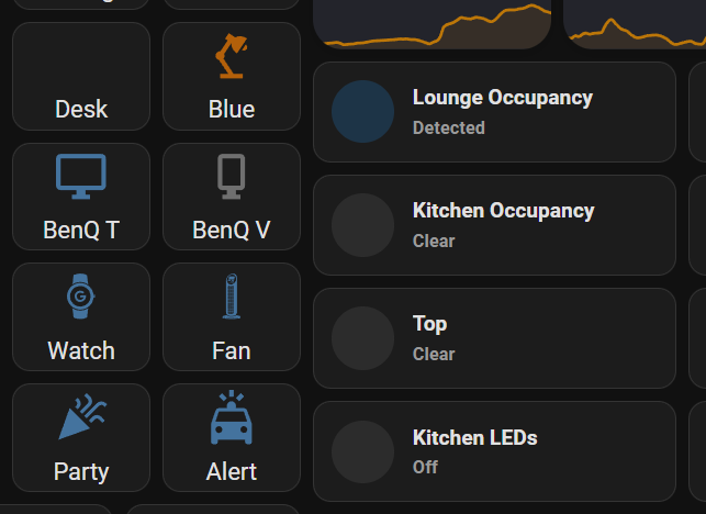

To explain: On Chrome it looks like I need to clear the cache but doesn’t work - some of the icons are grayed out. Usually a cache clear fixes the issue. However, on Edge, Firefox and the android app it is exactly the same.
This is a weird one. I have rebooted, restarted the RPi, rebooted the internet… Still the same.
Think this started after a recent (today?). HA update.

What I meant was the icons arnt showing as below. One is now unavailable though the BenQ V, 2 mins to fix that. Typical lol.
So the icon for Desk has vanished, and so had the Kitchen Occupancy, Top and Kitchen LEDs.
As I said, same ‘front end displayed’ on all browsers.

Since some icons are blue and other grey, I still think you have an issue with some devices not being available.
Check your integrations to see if everything is OK there:
Open your Home Assistant instance and show your integrations.
All integrations are working, and all show up just fine on my bubble cards. If I walk into the kitchen, the occupancy and LEDs ‘circles’ change colour. But the icons that were in the centre will not appear, as I said, same on all browsers.

Are using custom icons ?

Hi folks, re message about using custom icons yesterday. Well, it turns out that was the issue - some of the phu: icons seem to have been removed on its last update. Found this link to the issue as well: PHU icons “sometimes” loading - found a replicatable issue
Have updated the icons all now okay. No idea why some of the icons have been removed though?
Thank for your help folks.
So the cards were functioning, only the icons not displayed correctly!?
Aye, all was working as such just the icons had vanished and it did initially look like a caching issue. Some of the icons in phu: appear to have been removed after its last update, no idea why.
I noticed your thread (cause you tagged mine. :)) and I think this may be the issue you’re seeing: renames, no removals – Rename SVG files to match previous icon names in HA by mathoudebine · Pull Request #1109 · elax46/custom-brand-icons · GitHub
