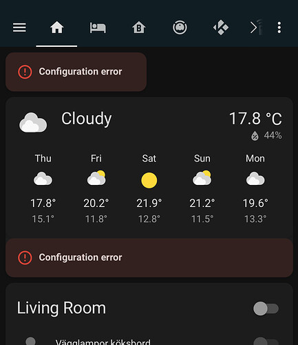

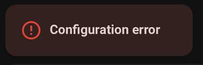

Hi, so right now there is a brief flash of “configuration error” then the actual card is presented. This is one example of a card flashing - I cant really see any unusual:

Also, the last part of this card - the hourly part flashes:
type: custom:vertical-stack-in-card
cards:
  - show_current: true
    show_forecast: true
    type: weather-forecast
    entity: weather.forecast_home
    forecast_type: daily
    secondary_info_attribute: humidity
  - type: custom:hourly-weather
    icons: true
    num_segments: "16"
    show_precipitation_amounts: true
I’d suggest disabling - type: custom:hourly-weather temporarily and see if the response time improves. Major changes were made to Weather in HA. I’ look at the code for this card, but my gut tells me it is polling a lot.

I tried to remove the card and delete the hourly integration, but a couple of the other custom cards still flashes… I just wish there was a way to diagnose…
If you use chrome, press F12 and look for any errors there
This is really bugging me. I’ve tracked down all the errors and corrected them via Chrome dev console. Tried to disable integrations, addons nothing has any impact…
