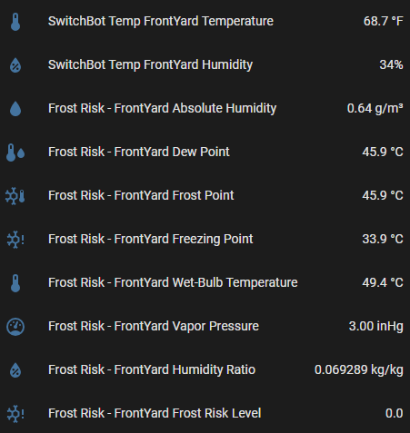

Hi @Patrick1610!
I just installed the integration and I’m now looking at the device info. I understand that (almost all of) the rest of the world is working on a reasonable temperature scale, but - unfortunately - the country I’m is not :frowning:
Is there a way to convert this to Fahrenheit so that it calculates properly?
Looks like the Frost Risk Level will not tell me anything when we get closer or even below to the freezing point of 32F.
Current Temperature 68F:
Simulated Below-Freezing Temperature - 28F:
