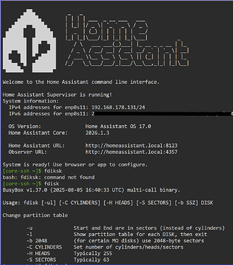

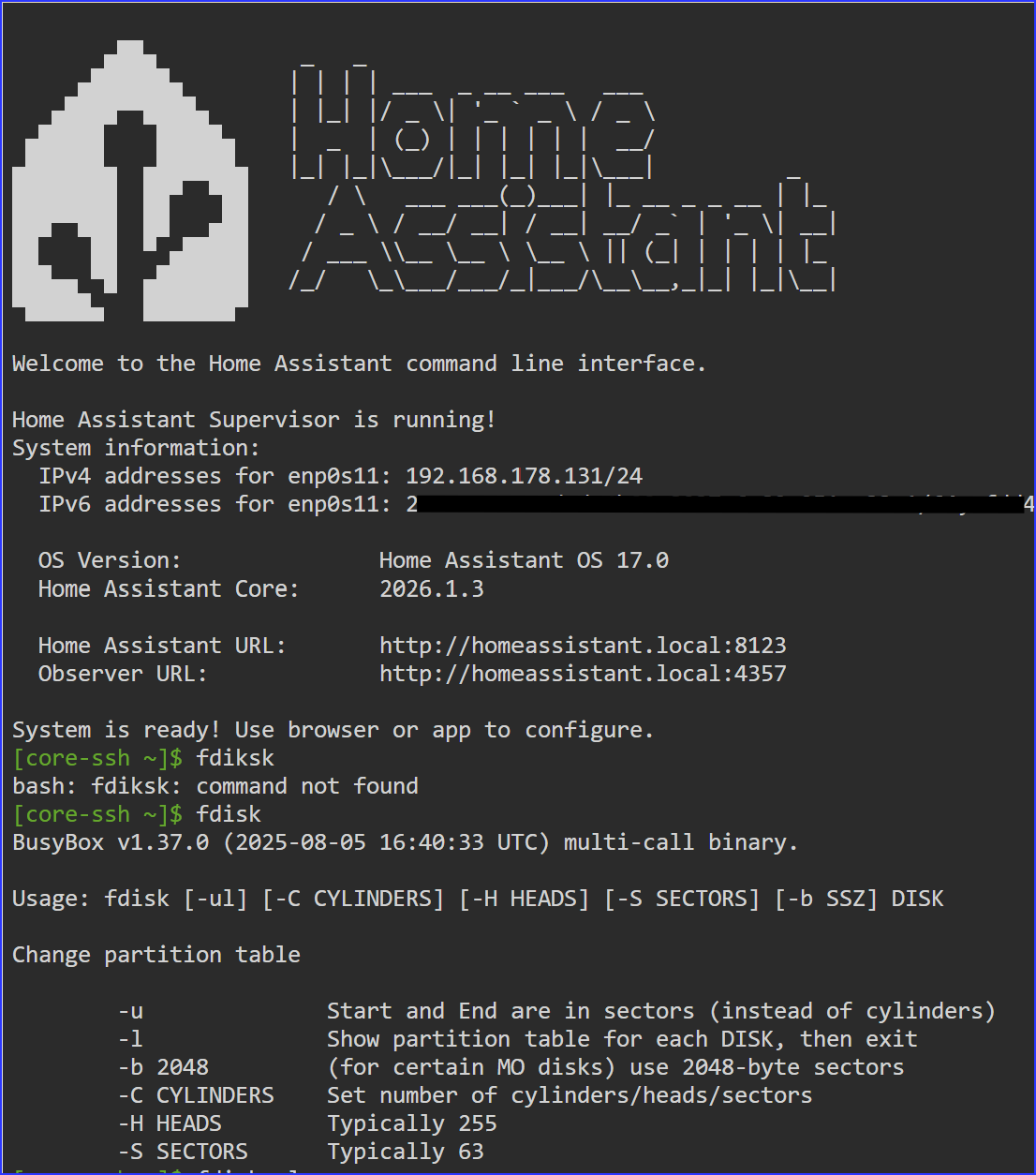

I obviosly installed Terminal/SSH and if I type the command “fdisk --help” it shows all the options, but if I want to list all the disks with “fdisk -l” it just does nothing. Same with any “fsck” commands.

This is the normal behavior if you are using HA’s Terminal function. fdisk is not part of the Supervisor shell.
Use ‘help’ to get a list of known commands.
