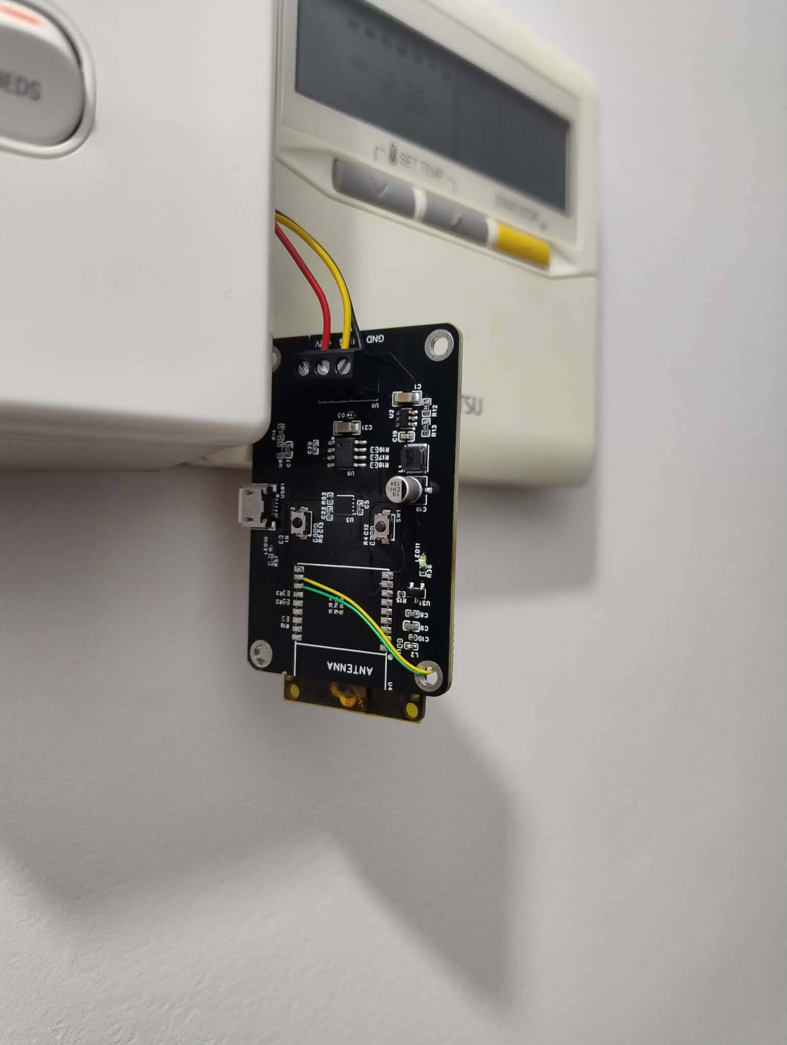

I have the nathansags boards working great on my four split systems - set as “primary” remote in the config. Connected in place of the Fujitsu wifi adapters.

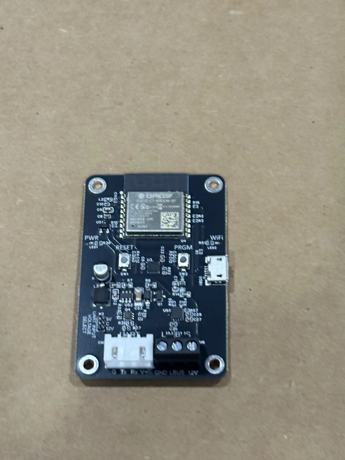

Hey Guys,
Finally the Gen 2 Fuji boards have arrived and I have tested this version on my own AC unit. All has been working very well for the past week or so. This new version has both a new surface mount Lin transceiver IC and a JST plug to a level shifted to the uart port.
Both the Lin and the uart are utilising the same uart0 port of the esp32-c3 so you will not be able to use them at the sametime but you can certainly use either. You can also via a jumper select what voltage you will be supplying the board with when using the uart only, 5v or 12v.
If there is want for it we could look at moving the JST to uart1, will see how we go.
Should anyone still be interested jump on it as the last 55 boards went quick, I will place an order for more once I get down to half to reduce the wait time.
Link: ESP32-C3 3 Wire Lin Transceiver Board | eBay Australia
Nathan

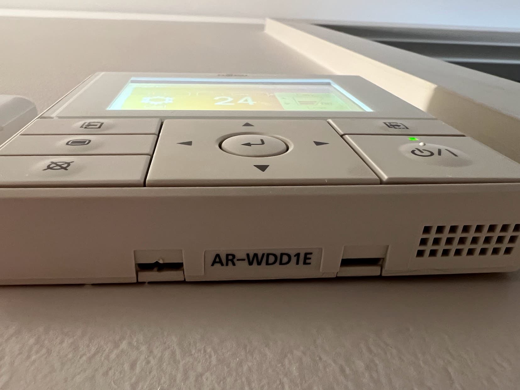

Hi, I just ordered a board. Does this work with Fujitsu AR-WDD1E controller? Does the board already come flashed or will I need to do that? Thanks

It doesn’t normally come flashed but there’s no issues in me flashing it for you. I will knock one up this arvo. All you should have to do is connect it to your WiFi and the AC unit. I have the exact same controller on my AC unit and my board has been running for many months without issue. I didn’t want anything else on the wall in the lounge room for my install, so I ran a cable from the indoor unit to the man hole and installed the board there so access was easy.
If you PM me your email I have a dropbox folder I can link you to where I have all the info I have accumulated on this setup and 3d models for the enclosure.

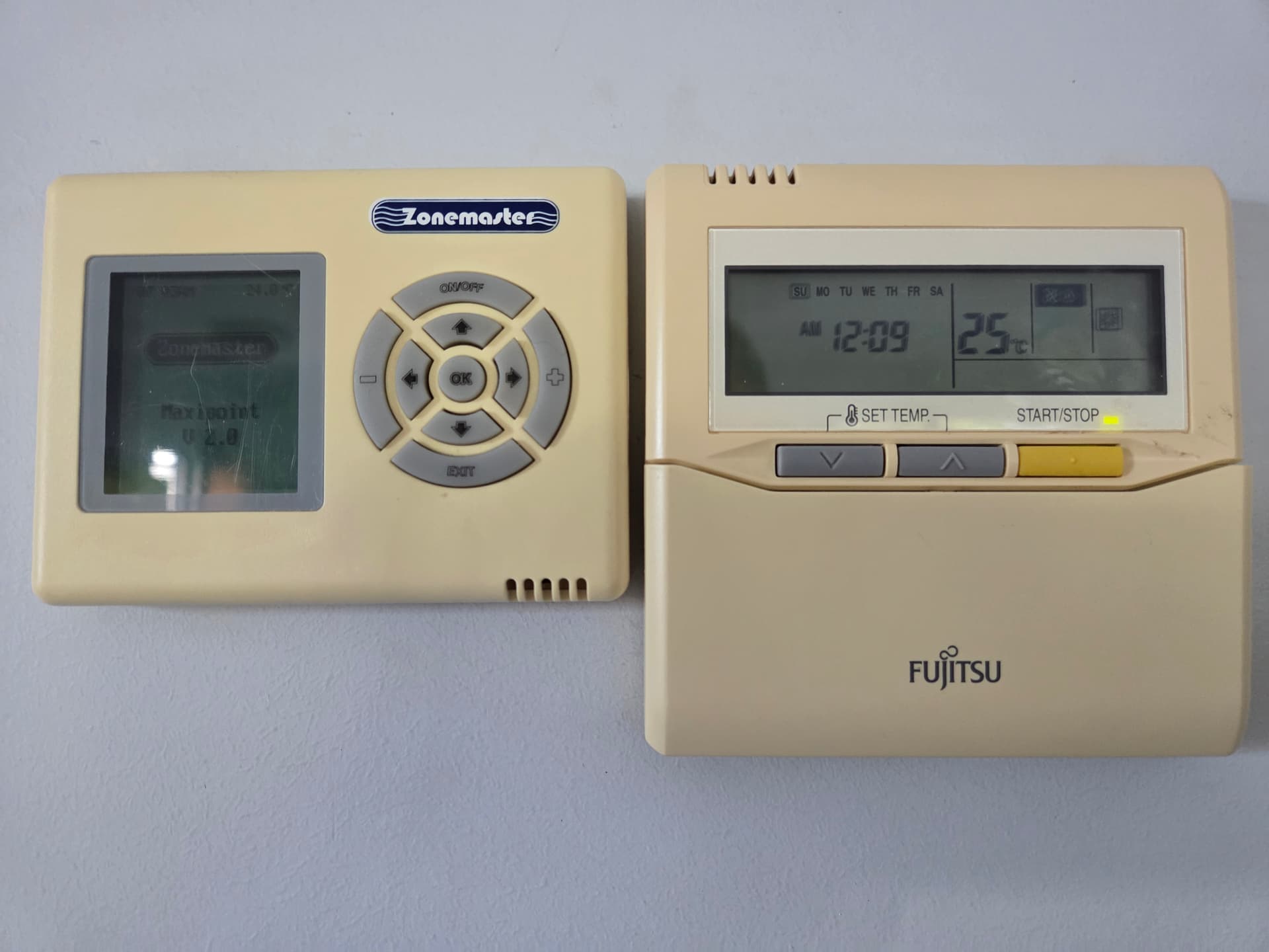

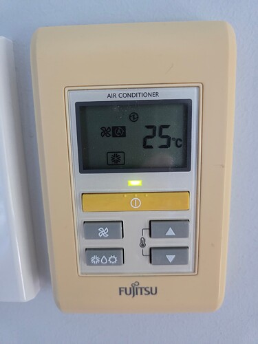

I have a slightly different set-up to most as I already have two wired fujitsu wall panels and am hoping to add the esp32 controller as the third. I have configured my esp32 yaml with “controller address: 2” but this only displays the status of the system in Home Assistant rather than allowing me to control it. Initialisation stage sensor shows 2/4. Has anyone else managed to get this type of configuration working? Are there some dip switches that need changing?
I have confirmed I can control the aircon if I disconnect the smaller panel and change the yaml to “controller address: 1”
Any help would be appreciated.
Thanks
Cameron
My understanding is most Fujitsu ACs only support 2 controllers.
While the protocol appears to allow controller addresses 0-15 (and I have successfully tested with 3 controllers with an ARU18RLF), all available documentation states at most 2 controllers are supported.

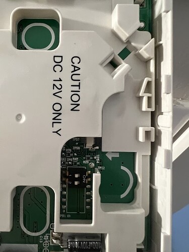

Documentation for the OEM controllers show they only support Primary (0) and Secondary (1), so there should be no other relevant dip switch settings.
If initialization stops on 2/4, it sounds like the secondary controller is not giving the token to the esp device. You could try swapping the addresses on your OEM controllers to see if they act differently (you will lose some features, like scheduling on your primary controller).
If that doesn’t work, can you capture and share the logs from the system starting up, or get a packet capture of the system starting up using the TZSP configuration and Wireshark?

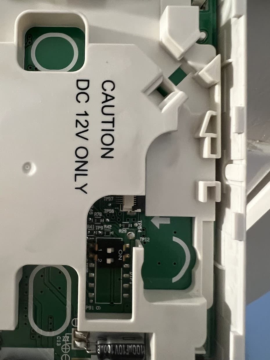

Are these dip switches correct? Thanks
