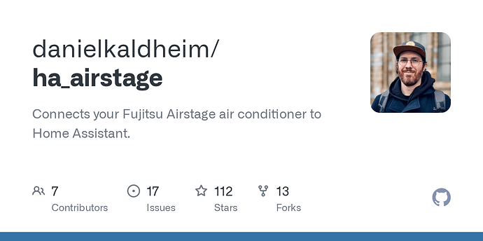

I’m not familiar with that integration, GitHub - danielkaldheim/ha_airstage: Connects your Fujitsu Airstage air conditioner to Home Assistant. is the one that many others use and is maintained.
And afaik air stage api integration has not been removed, but it’s not recommended due to the above issues.

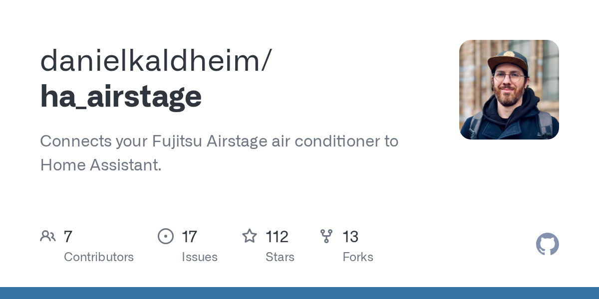

Just wanted to add the Daniel Kaldheim AIRSTAGE repository from GitHub. When I try the link GitHub - danielkaldheim/ha_airstage: Connects your Fujitsu Airstage air conditioner to Home Assistant. in the add repository command, hacs replies that this is not a valid add on repository. Anybody can help with a solution or the correct link? Thanks in advance for your support :slight_smile:
Kind regards
Did you add the following url as a custom repository in HACS?
Type = integration.
Works here, tried removing and re-adding
