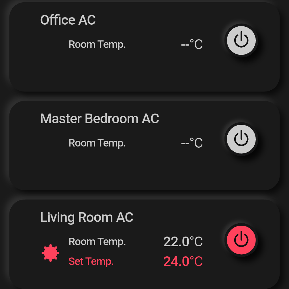

Has anyone figured out why the units report 65535 for iu_indoor_tmp when they are off, but not all the time?
I’ve had it when they’ve reported internal temps when not switched on, permanently - so I can track tmps - but recently it’s gone back to no report unless on…
If I manually query the devices with curl I get:
“iu_indoor_tmp”:“65535”
I thought that too, until I put a temp sensor next to my units, and they were spot on for me. The bigger issue was that because the thermostat is on the unit, it tends to deviate from the room temperature. I ended up using external sensors, and adjusting the setpoint through HA on the fly.

My units were all reading a few degrees off - so I had to calibrate (much better now) - although per above, if they would continue reporting temps when they were “not switched on” (like they used to) that would be handy! :\
One thing I discovered last night is that some attributes get ignored if others are included. A case I observed last night was iu_pow_cons not returning when requested with iu_hmn_det. That said, after rereading your post I don’t think that’s your issue at hand.
I was of the impression that iu_internal_tmp wasn’t produced while the unit was off or in fan mode, but testing now I’m not observing that. I’m gonna give them some time and maybe play with resetting a breaker to see how the system behaves on a clean start without ever going outside of off/fan.
I could do a flat reset to test.
Currently I am getting this (in Airstage itself)…(3 of 4 IUs)

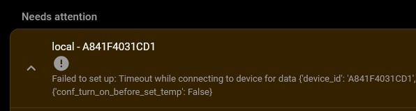

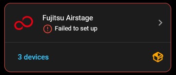

I have a Shelly Switch to control the Power Unit Outdoor; basically I turn off if not needed
but the result when I turn off the integration show up : Failed to set up:
It means eaach time when I turn on I need to reload the Integration for each AirCon.
Any idea or suggestions?
Thanks for support
Can you check if the AC’s are getting a new IP address after coming back online? I would assume that they should come back by themselves once back online.
ip still be the same
they donìt came back after return online. To have it I need to reload each time
Logger: homeassistant.config_entries
Source: config_entries.py:761
First occurred: 10:35:27 AM (3 occurrences)
Last logged: 10:35:27 AM
Error setting up entry local - CC4740096185 for fujitsu_airstage: Timeout while connecting to device for data {'device_id': 'CC4740096185', 'ip_address': 'xxx.xxx.x.xxx'} and options {'conf_turn_on_before_set_temp': False}
Error setting up entry local - A841F4031CD1 for fujitsu_airstage: Timeout while connecting to device for data {'device_id': 'A841F4031CD1', 'ip_address': xxx.xxx.x.xx'} and options {'conf_turn_on_before_set_temp': False}
Error setting up entry local - 106838E4DB61 for fujitsu_airstage: Timeout while connecting to device for data {'device_id': '106838E4DB61', 'ip_address': 'xxx.xxx.x.xxx'} and options {'conf_turn_on_before_set_temp': False}

homeassistant.exceptions.ConfigEntryError: Timeout while connecting to device for data {'device_id': 'CC4740096185', 'ip_address': 'xxx.xxx.x.xxx'} and options {'conf_turn_on_before_set_temp': False}
You can consider to create an automation where if you turn on the Shelly device after it was ‘off’, it reloads the devices.
What version are you running and now long have you waited after restoring power?
turn on +/- more than 6h
If I understood your point: yeaap that’s was my first idea >> it seems is not restore “entry device”)
  • Installation method Home Assistant OS
  • Core 2025.12.1
  • Supervisor 2025.12.2
  • Operating System 16.3
  • Frontend 20251203.1
Fujitsu Airstage Version 1.7.1
Upgrade to 1.7.3, there have been changes for how connectivity is handled that may improve things for you
okkey updated to 1.7.3 done
Let’s see what happens :slight_smile:

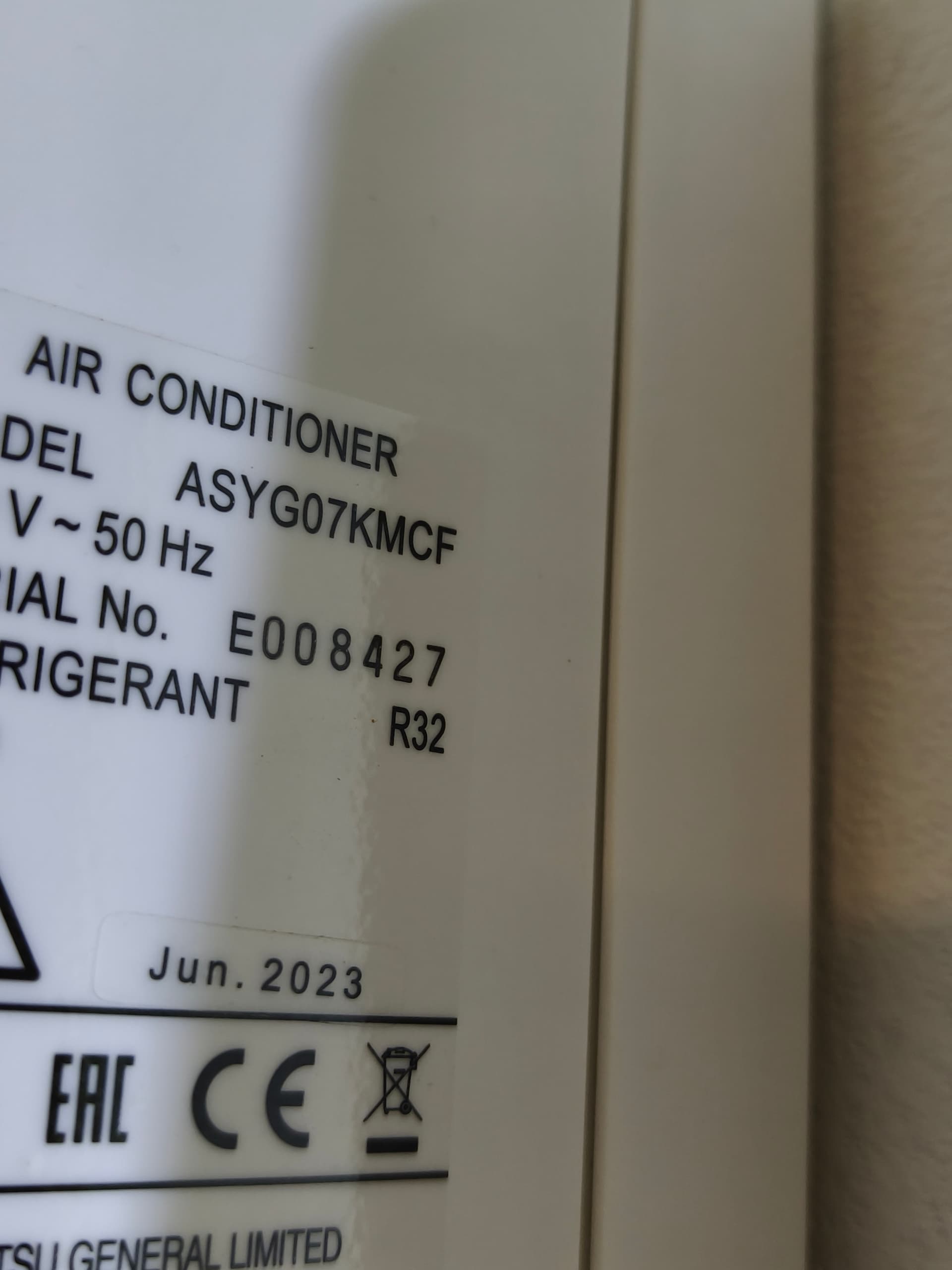

1- it shows >> ASYG12KMCE , in real are KMCF series all 3 AC

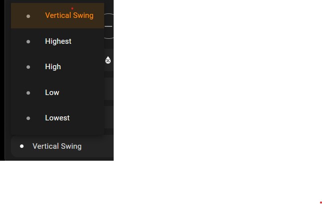

2 - with KMCF there is the choice to setup wind direction ( I can imagine not easy to define):
  1. It just shows what your unit is declaring it’s model as.
  2. Sounds like your talking about swing mode. It’s there in the climate card, you may have to swipe the list to see all the options
1 - my label on one of my 3ac:
in FGLair app were shown as KMCF , as on my invoice

2 - i talking about up/down airflow direction
there are 6 positions numbered from 1 to 6
could be those ones?
those are F
an Speed
  1. If you go to developer tools and pull up the climate entity, there is a model attribute in there. That is the model identifier read verbatim from fujitsu. This integration is just showing the information provided
  2. Yes, those are fan direction, which sounds like what you’re asking about
Let’s try in different way, :
1- the model attribute shoen in ha = KMCE is wrong
mine 3Ac are the series KMCF
I do not know which data info are used to be compared/match into “fujitsu database”
serial number??
Model id???
Please let me know thanks in advance
2- Airflow direction ( not Fan Speed)
where i can find this functionality?
Is implemented in this integration?
Thanks in advance for your reply
  1. You keep saying the same thing and I keep giving you the same response. The model being shown from the integration is simply putting out what’s your unit is telling the integration. Period
  2. Yes, that is swing direction, it’s next to fan speed on the climate entity
and before: If you go to developer tools and pull up the climate entity, there is a model attribute in there. That is the model identifier read verbatim from fujitsu. This integration is just showing the information provided
thanks John anyway, we talk “different language”
