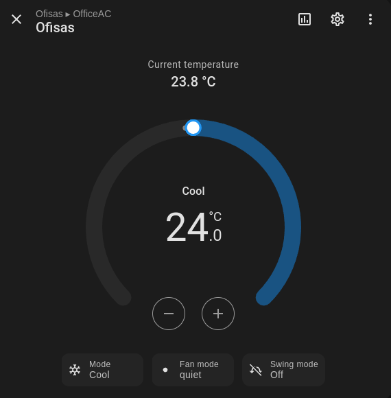

With 1.3.14 I added swing modes to the climate entity
Are you planning to move some more of the functions into the climate card as well? I believe most if not all of them can be. The dongles have been flawless now since the mqtt fix you did in the earlier version.
Yes, I will move them. It's nice to hear :slight_smile:

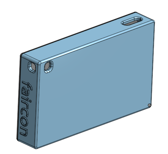

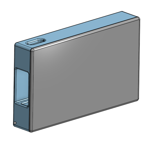

Any chance the STL for the USB style case can be shared?

Hi, I use such outer dimensions for my ready-to-use dongle 55.4 x 32.9 x 9.8.
Since it is designed exactly for my PCB’s, I will keep this one design private :blush:
Totally understand, I was more interested in the external measurements anyway, so thanks for sharing them, and thanks for your efforts in the project as a whole.
