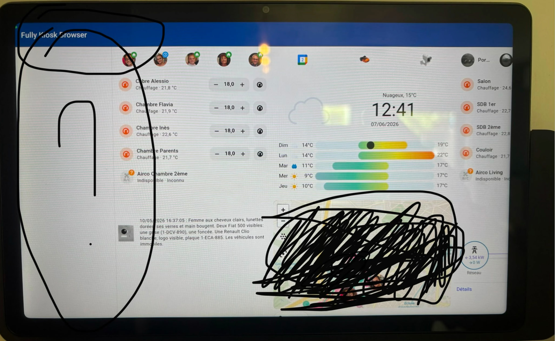

Hi there,
Since couple of days, Fully Kiosk browser is showing a
an empty panel on the left side as well as banner on the top with name of the application.
anybody knows what happens ?
Many Thanks !!
Same problem here. I search the solution, i will post here, if find it.
Solved for me ...
Fully_kiosk I though I never installed it, and though not showned in HACS, it was installed (you can find it in www folder ...
I updated to last release (version 14 think), and it solved the issue
Concerning the header at the top, this is a Fully Kiosk Browser option I activated my mistake (A customizable Action bar you can display or not).
What exactly did you update? I installed the latest beta version from the fully kiosk, but the empty space is still there.
You need to go to HACS, and update Kiosk Mode to v14.0.0
Fully Kiosk Browser is just that - a browser. There is an integration for HA, but you only need that if you want to change its settings remotely or allow HA to access the camera in the tablet. It's not necessary for normal use - eg in a wall dashboard.
Kiosk Mode from HACS is something completely different.
To remove the header in Fully Kiosk you probably need to change the browser settings - unfortunately there are quite a lot of them, so it's difficult to say which one in your setup. Try experimenting.
