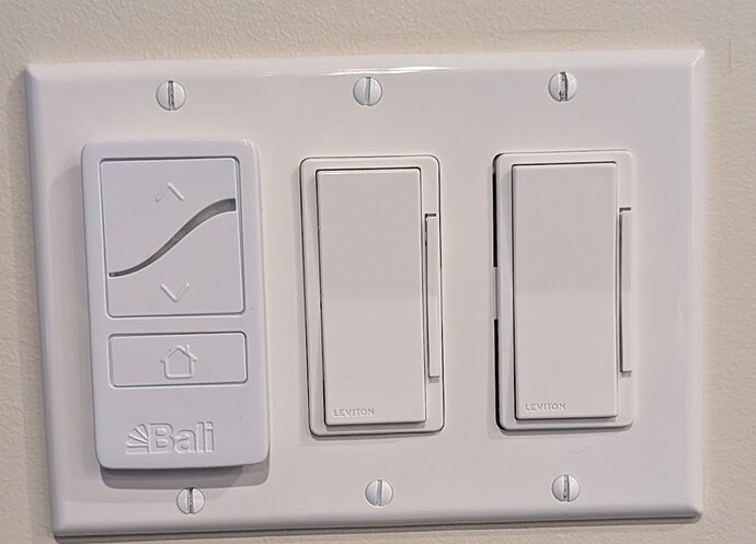

I have plus remotes, no premium remotes; I never use the home button - basic would have been fine. I have the Decora mount for the remotes, and keep the remote on the wall next to the room’s light switch.
