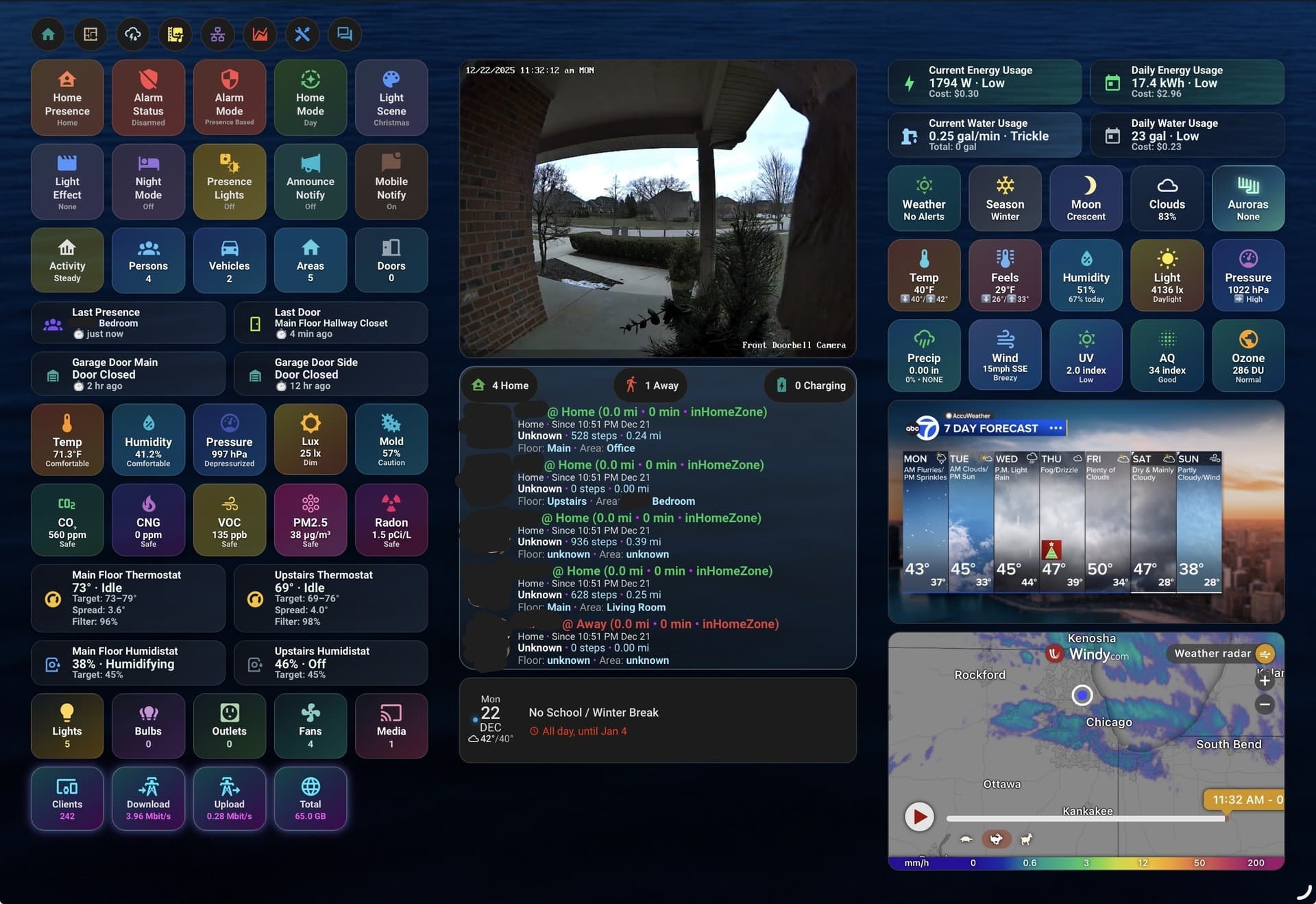

It appears that I’ve grown pretty fond of button-card! It’s so great at making nice compact buttons for my primary tablet dashboard main display.
Hello! nice dashboard. Please can you show me the yaml code for the card where you display the three badges with the total number of phones in the house (away, on charge)?
Curious about your 7 day weather from a TV station. What are you using for that? Looks much better than my previous attempts and I’ve gone to a less appealing weather card.
