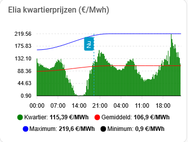

I have a sensor (sensor.elia_sdac_current_price) which contains 96 prices (as attribulte) for the current 24 hours (4 per hour). In the morning I want to know the minimum value in this list, to determine whether I should empty the battery to the grid or keep the power for later use. I have tried a statistics helper but that only works for values in the past and the minimum value most of the time is in the future. In the apexcharts-card that I am using to display the prices I can add a "min" calculation and that works fine, but I can see no way to use that value in an automation.

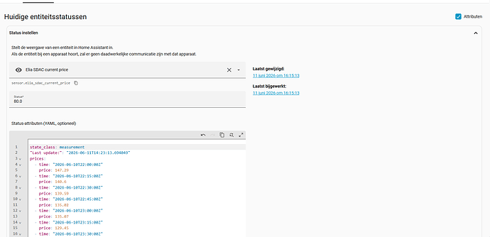

Settings > Dev Tools > States.
Find your entity and take a screenshot including the state and attributes shown on the right side of the screen.

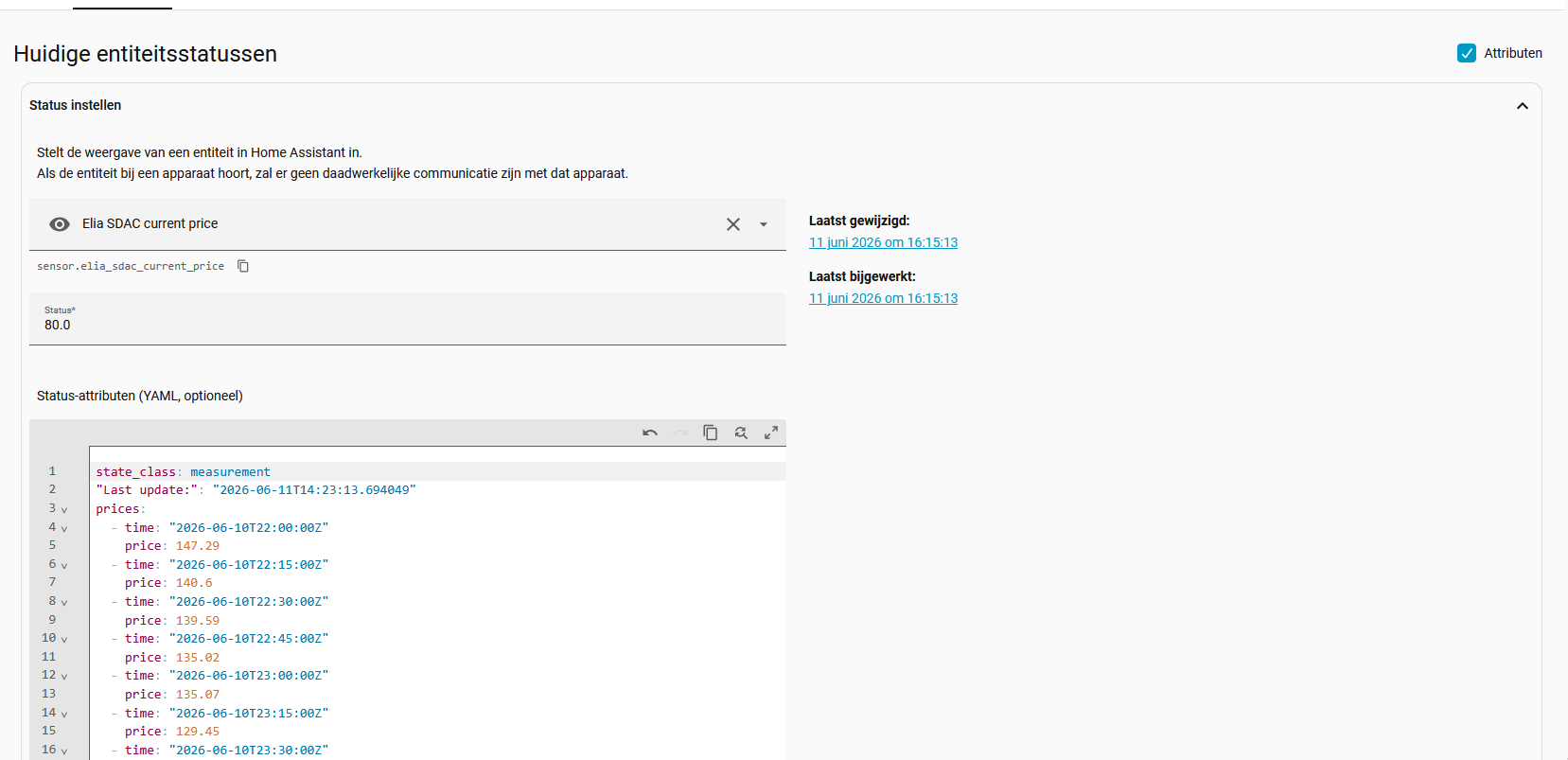

Nothing on the right side:
So, two things from that image. I was wondering if the state was a timestamp, but it's not, so you cannot trigger on that state change. Anyway, sounds like you want to trigger at some point in time.
Next, as you know, there's an attribute "prices" that is an array/list of dictionaries with a time and price keys.
If you go into Dev Tools -> Template and add this:
{{ state_attr('sensor.elia_sdac_current_price', 'prices') }}
You should see that array/list of dictionaries, and one of the keys is price as in your screenshot.
