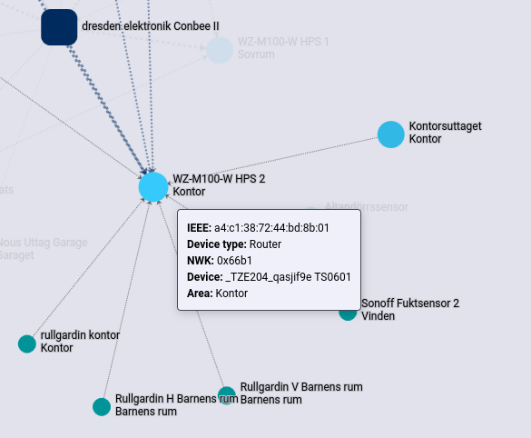

Wife asked me why the kids blinds where down.
Checked the automation, it opened them 6 hours ago, but they are closed.
Looking in the GUI, controls are reversed. When I press the arrow up they go down and report OPEN and when I press arrow down they go up and report CLOSED.
This didn’t use to be this way. They are all connected to a ConBee II
Reconfiguring doesn’t seem to help. I seem to have the same issue with all my Fyrtur now.
Firmware seems to differ but same issue.
