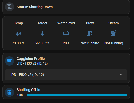

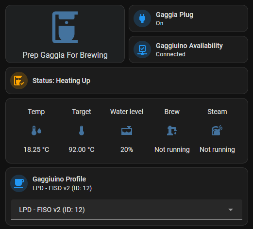

Here’s some screenshots of my dashboard, I can share the yaml for this and some notification automations too, if anyone wants em.

Sure! Here’s the dashboards I use, with a mobile-friendly version and a wider one I use on my wall-mounted tablet. Note that I am using the mushroom cards from HACS, so you’ll need to set that up first!
