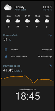

I get good results with the custom vertical stack-in card.
Alternatively, you can use a theme which makes the card background transparent.
  card-background-color: rgba(0,0,0,0)
  ha-card-border-color: rgba(0,0,0,0)
  ha-card-border-radius: "0px"
  ha-card-border-width: "0px"
