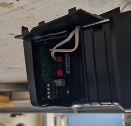

Garage door device

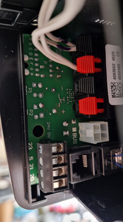

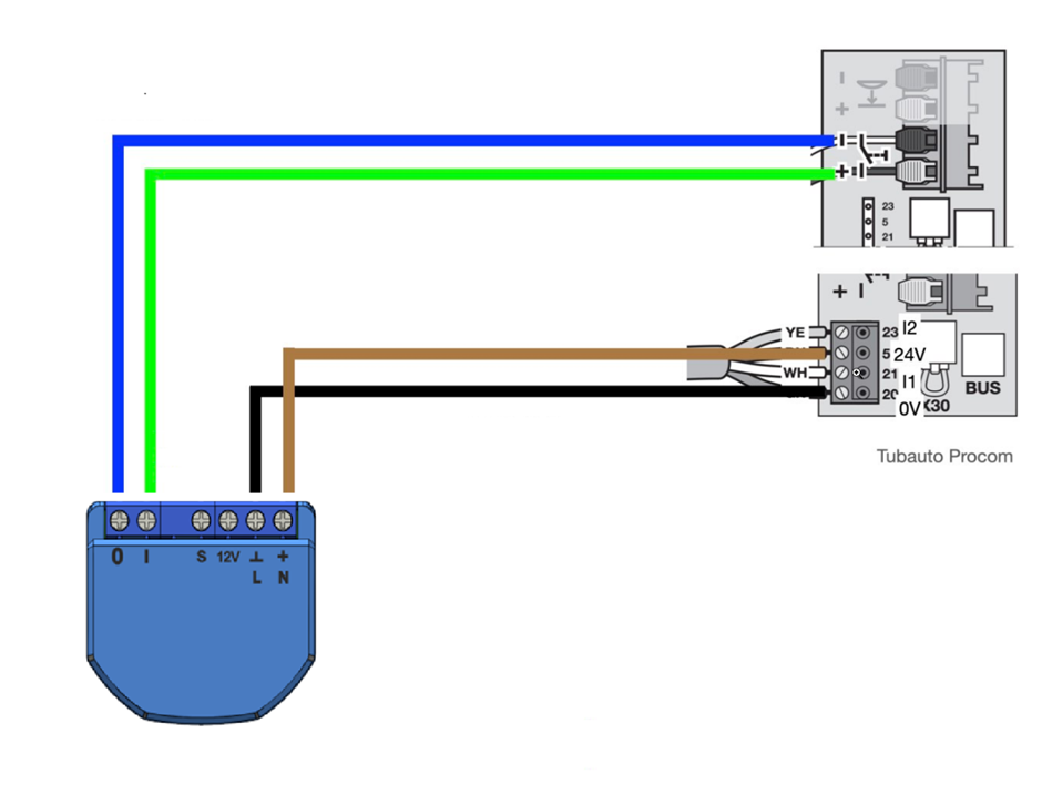

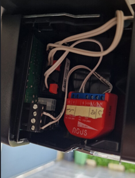

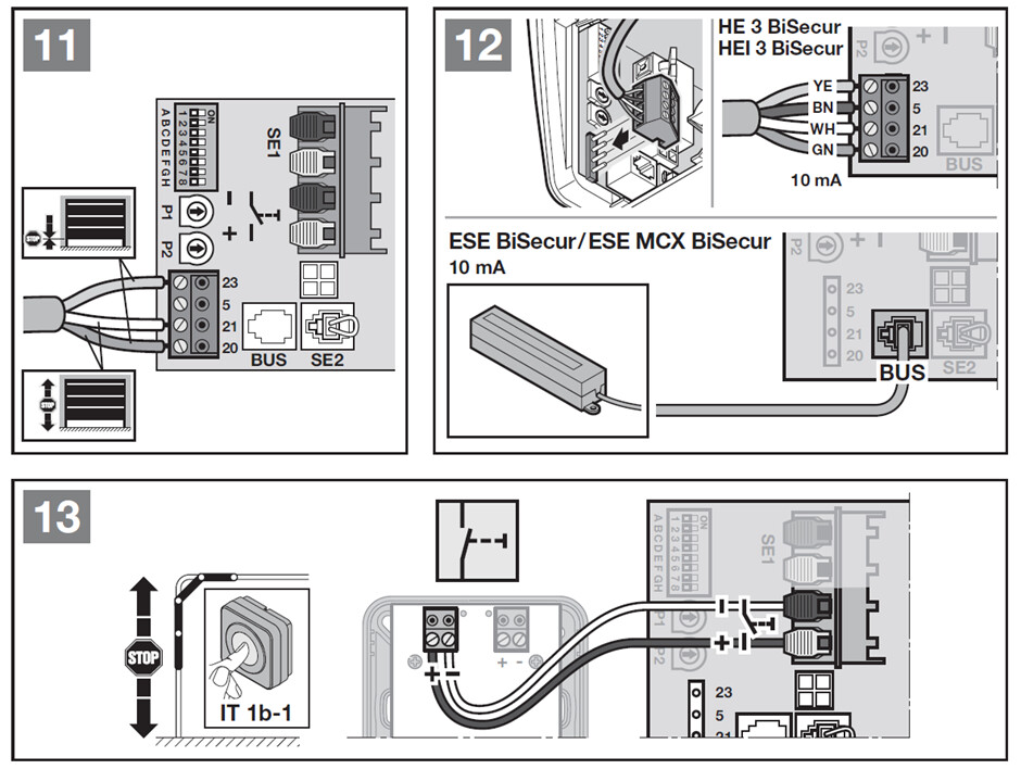

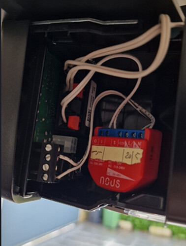

It is Procom 7-2
The documentation gives the figures 11 and 13

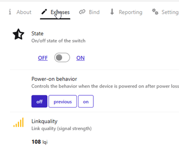

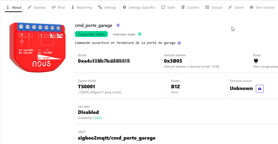

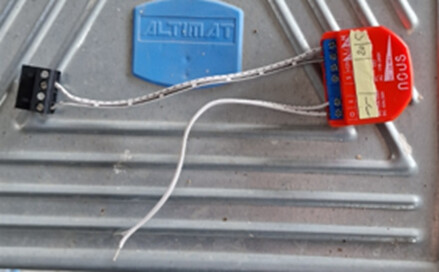

Zibgbee switch

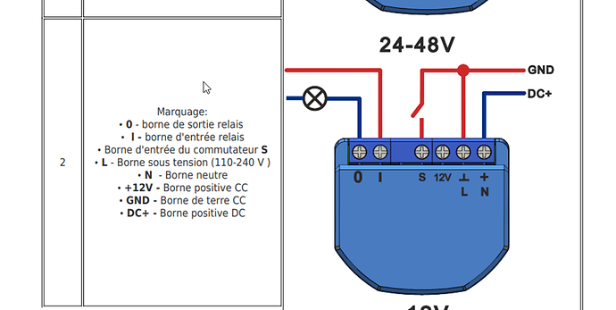

The device used is NOUS В1Z
https://nous.technology/product/pdf?slug=b1z&alias=FR+-+Manuel+De+L'Utilisateur
Schema

Procom

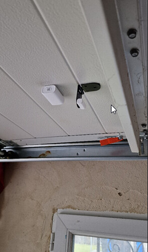

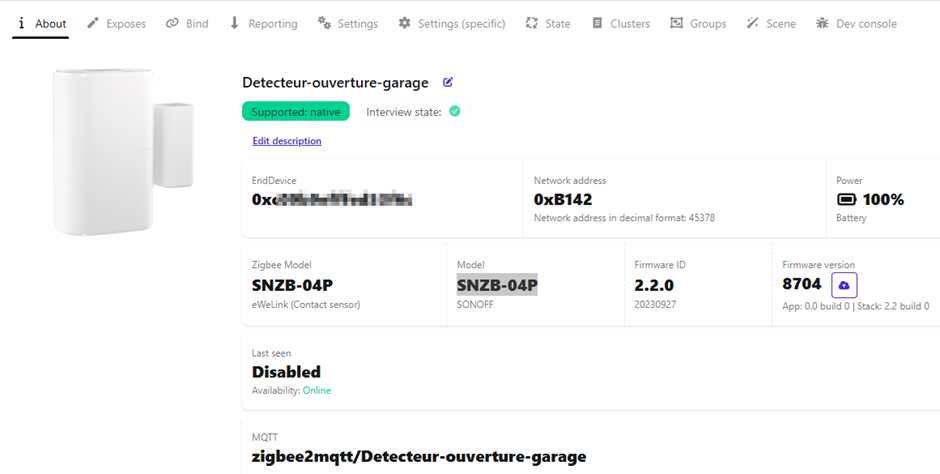

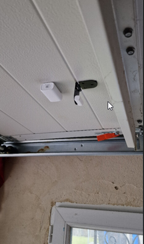

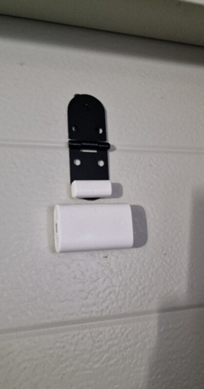

** Garage door position contact**
SONOFF SNZB-04P Zigbee Door Window Sensor
Door Hinge

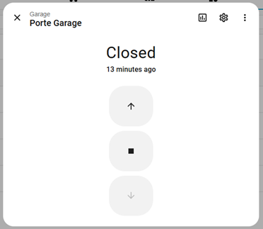

Home assistant integration
Template
  • cover:
    - name: “Porte Garage”
    unique_id: porte_garage_cover
    device_class: garage
    state: >
    {% if is_state(‘binary_sensor.detecteur_ouverture_garage_contact’, ‘off’) %}
    closed
    {% else %}
    open
    {% endif %}
    open_cover:
    - action: switch.turn_on
    entity_id: switch.cmd_porte_garage
    - delay:
    seconds: 2
    - action: switch.turn_off
    close_cover:
    - delay:
    seconds: 2
    stop_cover:
    - delay:
    seconds: 2
    availability: “{{ states(‘binary_sensor.detecteur_ouverture_garage_contact’) not in [‘unavailable’, ‘unknown’] }}”
