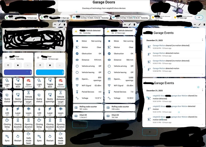

Garage Door Opener Control Using ratgdo32 disco
I installed two ratgdo32 disco devices on my Chamberlain 2.0 security devices and am loving the control and automations! I no longer need to use the horrendous MyQ app.
If you want to see all 34 entities for each device and be able to interact with the ones you can press for action or modify parameters along with all the information only entities, it’s quite elaborate. I was able to get them all organized on one dashboard page and am sharing that here for those interested.
  - title: ratgdo32 Disco Garage
    icon: mdi:garage
    theme: Backend-selected
    badges:
      - type: entity
        show_name: true
        show_state: true
        show_icon: true
        entity: device_tracker.ratgdo32_disco_first_garage_door
        show_entity_picture: false
        state_content:
          - state
          - ip
          - last_changed
        name: first Garage Controller
        icon: mdi:car-connected
      - type: entity
        show_name: true
        show_state: true
        show_icon: true
        state_content:
          - state
          - ip
          - last_changed
        name: second Garage Controller
        entity: device_tracker.ratgdo32disco_mac_hex
      - type: entity
        show_name: true
        show_state: true
        show_icon: true
        entity: sensor.ratgdo32_disco_first_garage_door_firmware_version
        name:
          - type: text
            text: first Garage Controller
          - type: entity
        icon: mdi:car-esp
        state_content:
          - state
          - last_updated
      - type: entity
        show_name: true
        show_state: true
        show_icon: true
        entity: sensor.ratgdo32_disco_second_garage_door_control_firmware_version
        name:
          - type: text
            text: second Garage Controller
          - type: entity
        icon: mdi:car-esp
        state_content:
          - state
          - last_updated
      - type: entity
        show_name: true
        show_state: true
        show_icon: true
        entity: binary_sensor.ratgdo32_disco_first_garage_door_vehicle_detected
        name:
          - type: text
            text: first's
          - type: entity
        state_content: last_changed
      - type: entity
        show_name: true
        show_state: true
        show_icon: true
        entity: >-
          binary_sensor.ratgdo32_disco_second_garage_door_control_vehicle_detected
        name:
          - type: text
            text: second's
          - type: entity
    type: sections
    max_columns: 3
    sections:
      - type: grid
        cards:
          - show_state: true
            show_name: true
            camera_view: live
            fit_mode: cover
            type: picture-entity
            entity: camera.garage_duo_floodlight_main
            camera_image: camera.garage_duo_floodlight_main
          - type: tile
            entity: cover.ratgdo32_disco_first_garage_door_control_door
            name:
              - type: text
                text: first
              - type: entity
            color: indigo
            hide_state: false
            state_content:
              - state
              - last_changed
            vertical: false
            tap_action:
              action: toggle
            features:
              - type: cover-open-close
              - type: cover-position
            features_position: bottom
          - type: tile
            entity: cover.ratgdo32_disco_second_garage_door_control_door
            name:
              - type: text
                text: second
              - type: entity
            color: light-blue
            hide_state: false
            state_content:
              - state
              - last_changed
            vertical: false
            tap_action:
              action: toggle
            features:
          - square: false
            type: grid
            columns: 3
            cards:
              - show_name: true
                show_icon: true
                type: button
                icon: mdi:lightbulb-auto-outline
                tap_action:
                  action: toggle
                show_state: true
                entity: light.ratgdo32_disco_first_garage_door_light
                name:
                  type: entity
              - show_name: true
                show_icon: true
                type: button
                icon: ''
                tap_action:
                  action: toggle
                entity: button.ratgdo32_disco_first_garage_door_toggle_door
                show_state: false
                name:
                  type: entity
              - show_name: true
                show_icon: true
                type: button
                icon: mdi:garage-variant-lock
                tap_action:
                  action: toggle
                entity: lock.ratgdo32_disco_first_garage_door_lock_remotes
                show_state: true
            grid_options:
              columns: 6
              rows: 1
          - square: false
            type: grid
            columns: 3
            cards:
              - show_name: true
                show_icon: true
                type: button
                tap_action:
                  action: toggle
                show_state: true
                entity: light.ratgdo32_disco_second_garage_door_control_light
                name:
                  type: entity
              - show_name: true
                show_icon: true
                type: button
                icon: ''
                tap_action:
                  action: toggle
                show_state: false
                name:
                  type: entity
              - show_name: true
                show_icon: true
                type: button
                tap_action:
                  action: toggle
                show_state: true
            grid_options:
              columns: 6
              rows: 1
          - type: heading
            icon: mdi:garage
            heading_style: subtitle
          - square: false
            type: grid
            columns: 3
            cards:
              - show_name: true
                show_icon: true
                type: button
                icon: mdi:jquery
                tap_action:
                  action: toggle
                show_state: false
                entity: button.ratgdo32_disco_first_garage_door_query_status
                name:
                  type: entity
              - show_name: true
                show_icon: true
                type: button
                icon: ''
                tap_action:
                  action: toggle
                show_state: false
                name:
                  type: entity
                entity: button.ratgdo32_disco_first_garage_door_query_openings
              - show_name: true
                show_icon: true
                type: button
                icon: mdi:format-line-height
                show_state: true
                name:
                  type: entity
                entity: number.ratgdo32disco_mac-hex_vehicle_distance_target
            grid_options:
              columns: 6
              rows: null
          - square: false
            type: grid
            columns: 3
            cards:
              - show_name: true
                show_icon: true
                type: button
                icon: mdi:jquery
                tap_action:
                  action: toggle
                show_state: false
                entity: button.ratgdo32_disco_second_garage_door_control_query_status
                name:
                  type: entity
              - show_name: true
                show_icon: true
                type: button
                icon: ''
                tap_action:
                  action: toggle
                show_state: false
                name:
                  type: entity
                entity: button.ratgdo32_disco_second_garage_door_control_query_openings
              - show_name: true
                show_icon: true
                type: button
                show_state: true
                name:
                  type: entity
                entity: >-
                  number.ratgdo32_disco_second_garage_door_control_vehicle_distance_target
            grid_options:
              columns: 6
              rows: null
          - square: false
            type: grid
            columns: 3
            cards:
              - show_name: true
                show_icon: true
                type: button
                icon: mdi:led-outline
                tap_action:
                  action: toggle
                show_state: true
                entity: switch.ratgdo32_disco_first_garage_door_led
                name:
                  type: entity
              - show_name: true
                show_icon: true
                type: button
                icon: mdi:laser-pointer
                tap_action:
                  action: toggle
                show_state: true
                entity: switch.ratgdo32_disco_first_garage_door_laser
              - show_name: true
                show_icon: true
                type: button
                icon: mdi:school
                tap_action:
                  action: toggle
                show_state: true
                entity: switch.ratgdo32_disco_first_garage_door_learn
                name:
                  type: entity
            grid_options:
              columns: 6
              rows: null
          - square: false
            type: grid
            columns: 3
            cards:
              - show_name: true
                show_icon: true
                type: button
                tap_action:
                  action: toggle
                show_state: true
                entity: switch.ratgdo32_disco_second_garage_door_control_led
                name:
                  type: entity
              - show_name: true
                show_icon: true
                type: button
                tap_action:
                  action: toggle
                show_state: true
                entity: switch.ratgdo32_disco_second_garage_door_control_laser
              - show_name: true
                show_icon: true
                type: button
                icon: mdi:school
                tap_action:
                  action: toggle
                show_state: true
                entity: switch.ratgdo32_disco_second_garage_door_control_learn
                name:
                  type: entity
            grid_options:
              columns: 6
              rows: null
          - square: false
            type: grid
            columns: 3
            cards:
              - show_name: true
                show_icon: true
                type: button
                icon: mdi:timer-alert-outline
                show_state: true
                name:
                  type: entity
                entity: number.ratgdo32_disco_first_garage_door_closing_delay
              - show_name: true
                show_icon: true
                type: button
                icon: mdi:timer-sand-complete
                show_state: true
                name:
                  type: entity
                entity: number.ratgdo32_disco_first_garage_door_closing_duration
              - show_name: true
                show_icon: true
                type: button
                show_state: true
                name:
                  type: entity
                entity: number.ratgdo32_disco_first_garage_door_opening_duration
            grid_options:
              columns: 6
              rows: null
          - square: false
            type: grid
            columns: 3
            cards:
              - show_name: true
                show_icon: true
                type: button
                show_state: true
                name:
                  type: entity
                entity: number.ratgdo32_disco_second_garage_door_control_closing_delay
              - show_name: true
                show_icon: true
                type: button
                show_state: true
                name:
                  type: entity
                entity: >-
                  number.ratgdo32_disco_second_garage_door_control_closing_duration
              - show_name: true
                show_icon: true
                type: button
                show_state: true
                name:
                  type: entity
                entity: >-
                  number.ratgdo32_disco_second_garage_door_control_opening_duration
            grid_options:
              columns: 6
              rows: null
          - square: false
            type: grid
            columns: 3
            cards:
              - show_name: true
                show_icon: true
                type: button
                icon: mdi:human-greeting-proximity
                tap_action:
                  action: toggle
                show_state: false
                name:
                  type: entity
                entity: button.ratgdo32_disco_first_garage_door_sync
              - show_name: true
                show_icon: true
                type: button
                icon: ''
                tap_action:
                  action: toggle
                show_state: false
                entity: button.ratgdo32_disco_first_garage_door_restart
                name:
                  type: entity
              - show_name: true
                show_icon: true
                type: button
                icon: ''
                tap_action:
                  action: toggle
                show_state: false
                name:
                  type: entity
                entity: button.ratgdo32_disco_first_garage_door_safe_mode_boot
            grid_options:
              columns: 6
              rows: null
          - square: false
            type: grid
            columns: 3
            cards:
              - show_name: true
                show_icon: true
                type: button
                tap_action:
                  action: toggle
                show_state: false
                name:
                  type: entity
                entity: button.ratgdo32_disco_second_garage_door_control_sync
              - show_name: true
                show_icon: true
                type: button
                icon: ''
                tap_action:
                  action: toggle
                show_state: false
                entity: button.ratgdo32_disco_second_garage_door_control_restart
                name:
                  type: entity
              - show_name: true
                show_icon: true
                type: button
                icon: ''
                tap_action:
                  action: toggle
                show_state: false
                name:
                  type: entity
                entity: button.ratgdo32_disco_second_garage_door_control_safe_mode_boot
