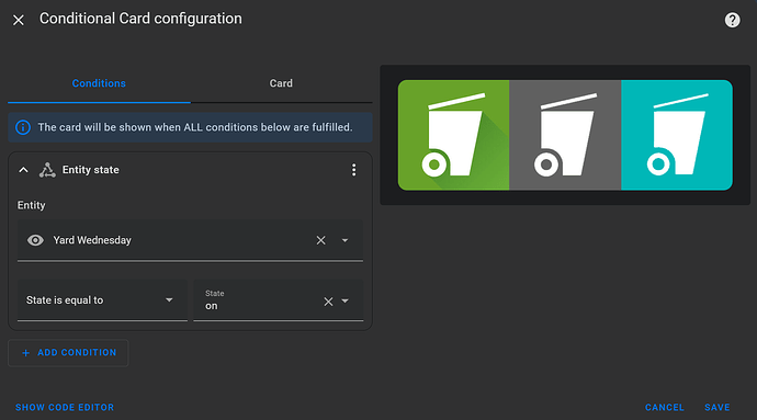

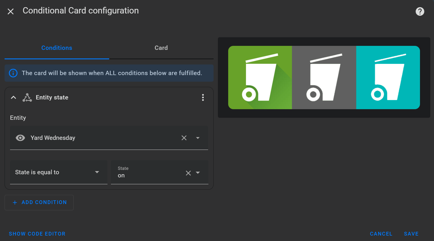

Then I uploaded two images in the www folder, which will be used by the cards.

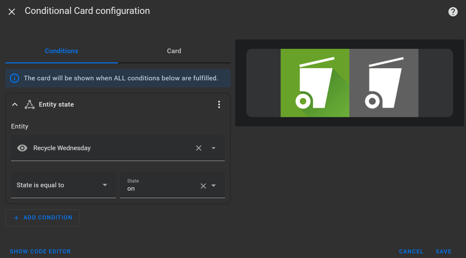

Then I added a Conditional card, and used a simple Picture card to show the current trash bins.
And here’s the other Conditional card.
