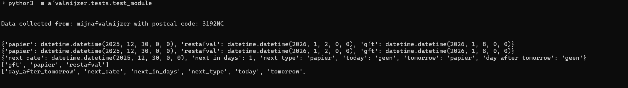

Good news, the component is able to fetch data with your postcal code and house number.
However, maybe there is something wrong with your config and/or maybe another issue. Did you check the logfiles on HASS restart?
You can also add some debug info to your configuration.yaml file, then you should see the data being fetched in the logs.

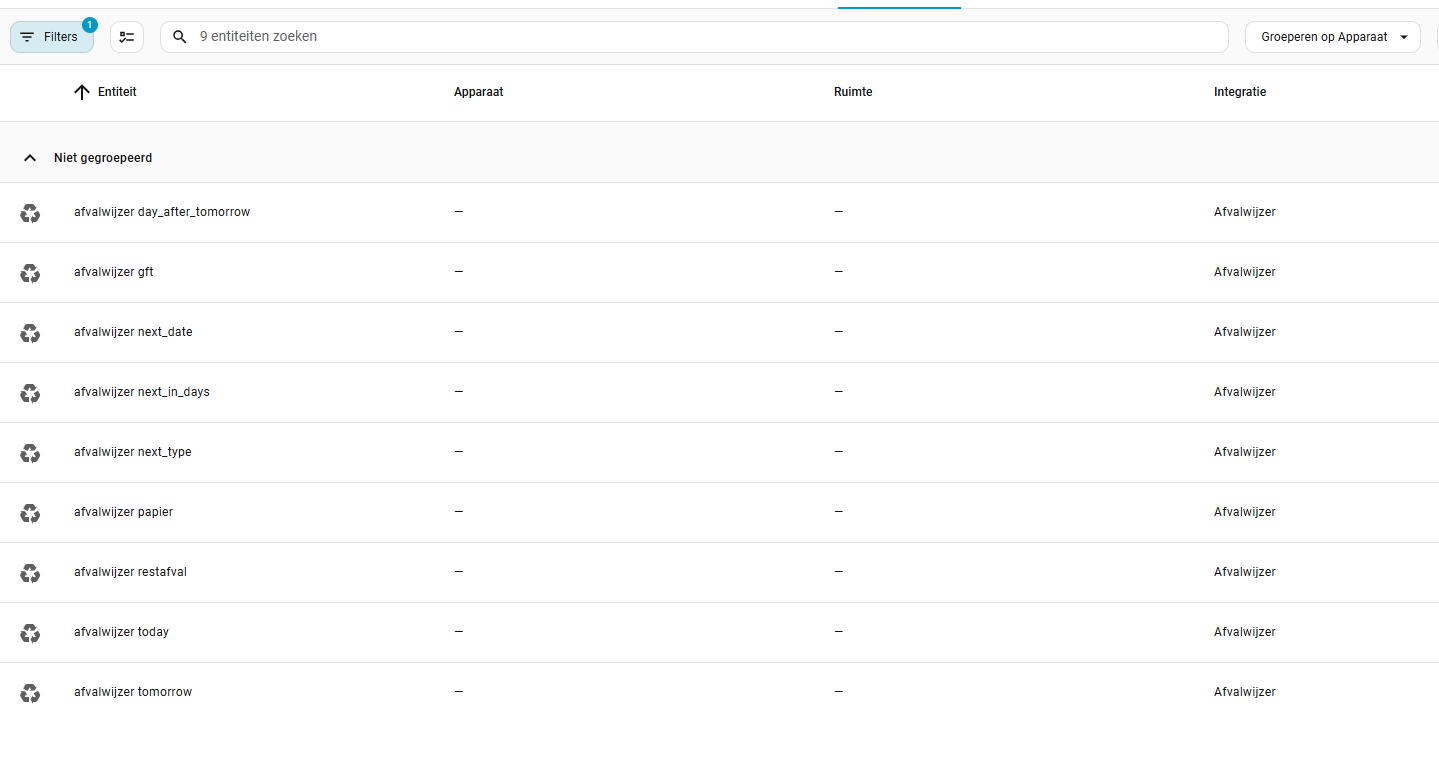

Another option is to check the enitites, maybe you ended up with additional entities and or entities with different names you used to have. Search for “afvalwijzer” in de developer section → states.

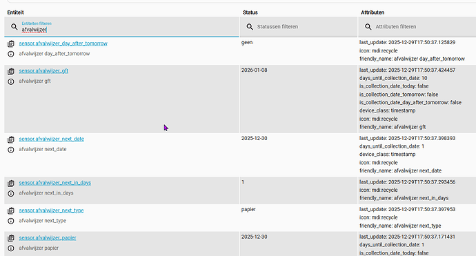

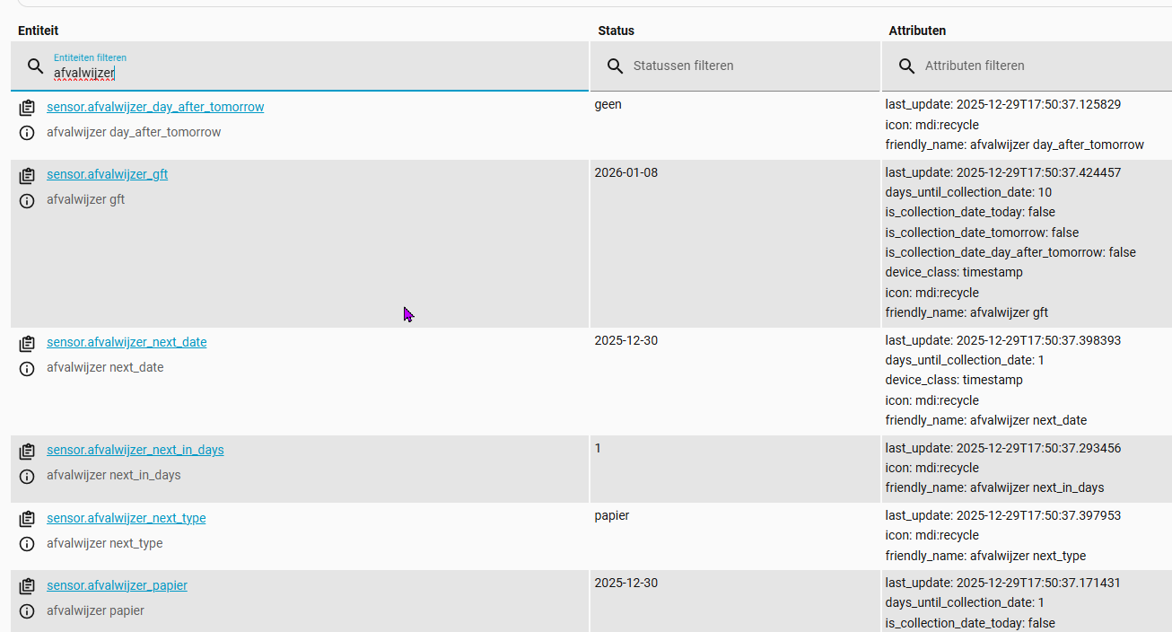

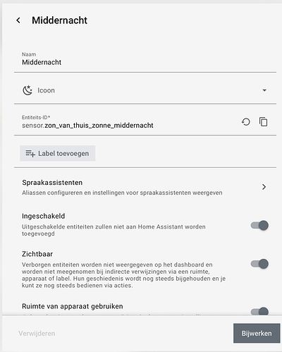

See both screenshots. At the developer section I see the info filled in but I do not see it at the entites on the integration page.
Do I overlook something?
Edit:
I have been able to solve it. Apparently it does not show any information on the entity tab. Once I added it to a dashboard I saw the information popping up.
Thanks for the assistance

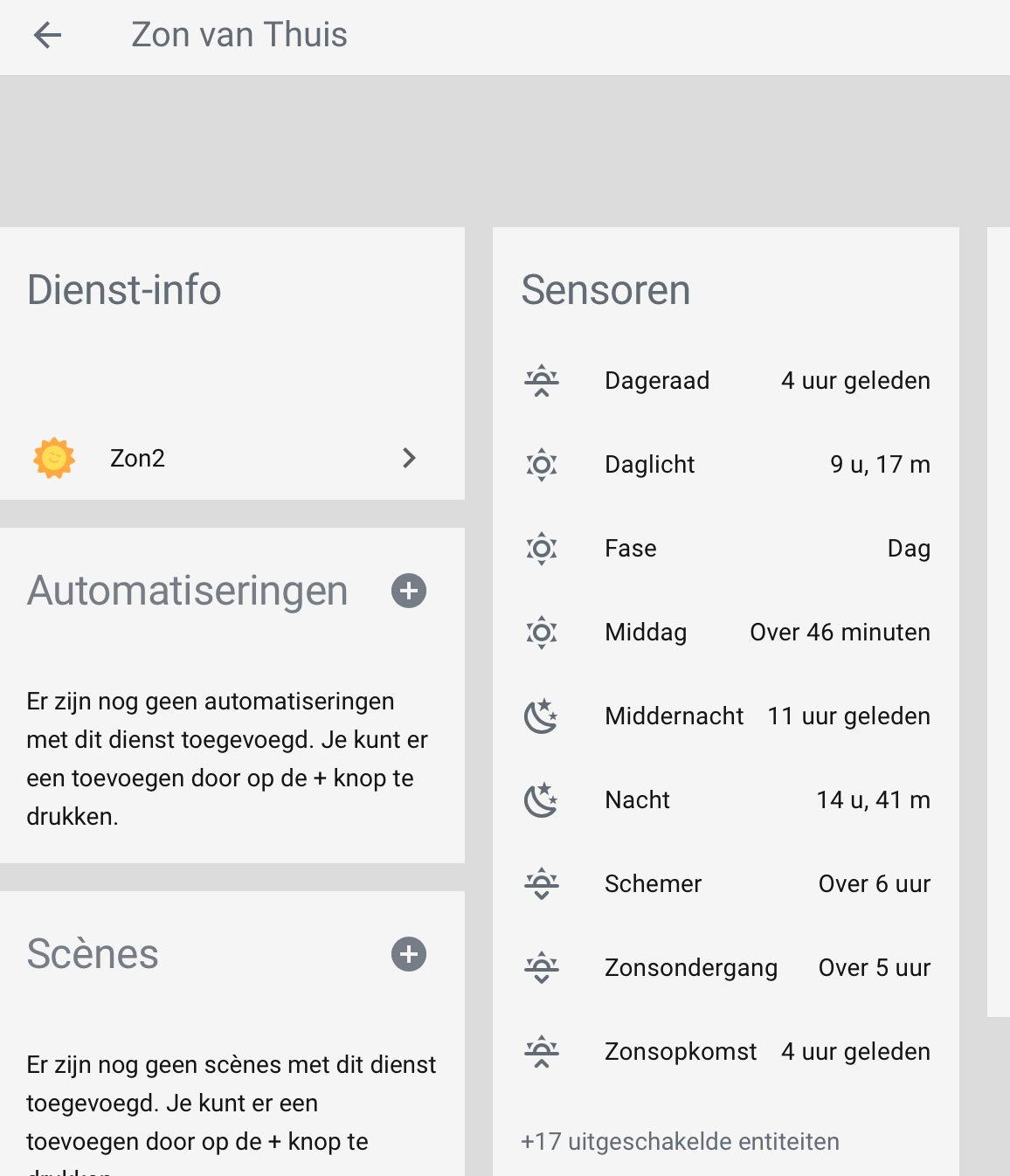

I’ve never thought about this really, but now I see the new user show the entities…
since this is a 100% Dutch integration, why dont we use Dutch naming and entity_id’s by default, or at least as a localization.
I’ve done that manually from the start (well, except for the ‘next’ entities, I should do that…), and there is not a single issue in backend that would require the integration to be English.
just a thought?

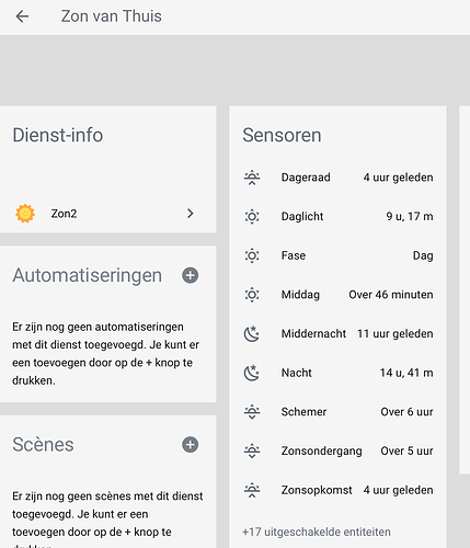

just check the Sun2 custom integration
local settings set the names and entity_id’s which really works well.
It’s all just a matter of incorporating translation files
and we’re not talking about backend system properties inside the python. obviously.
see: ha-sun2/custom_components/sun2/translations at master · pnbruckner/ha-sun2 · GitHub

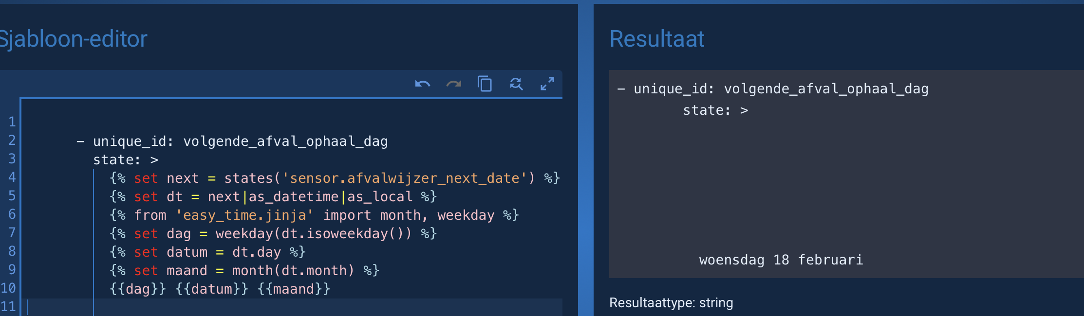

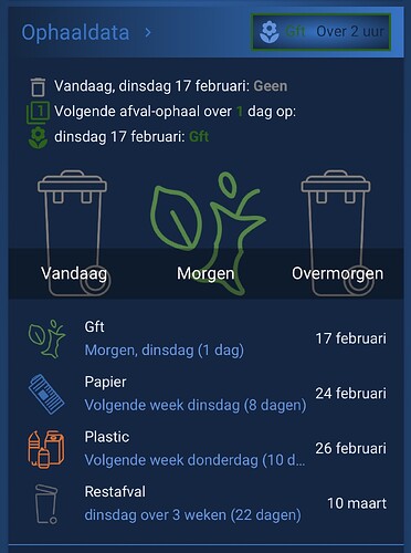

Hmm anyone else getting strange dates after the last update. ?
Seems the entities are alright but the templates I made suddenly show 1 day ahead…
Tomorrows pickup is states to be today…
Now what happened

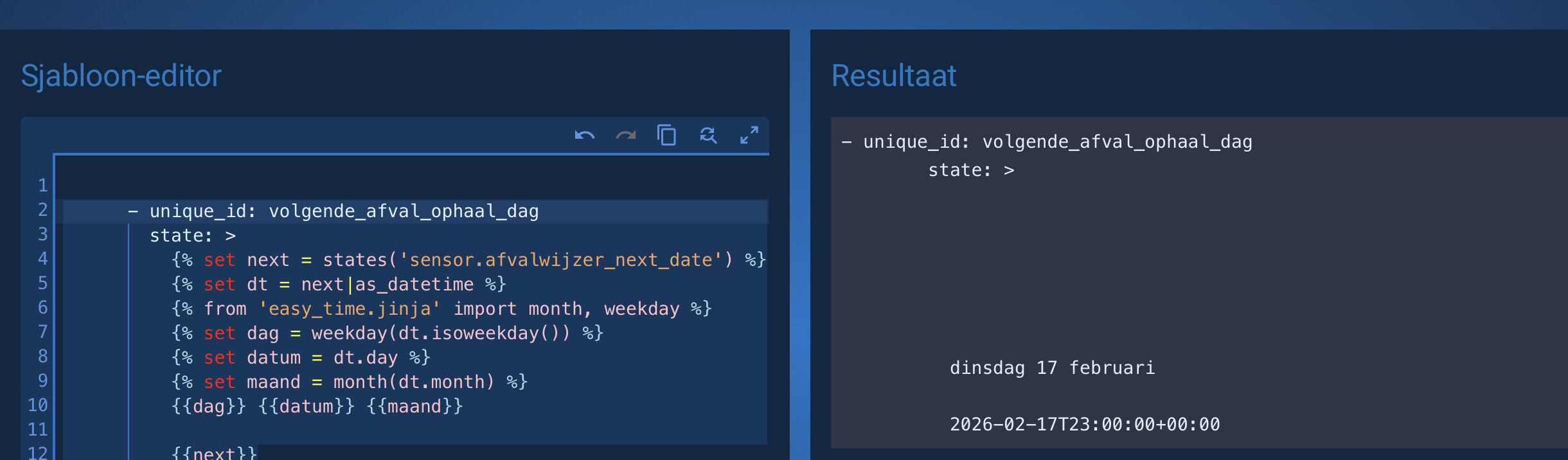

update:
right, seems sensor next date flukes:
      - unique_id: volgende_afval_ophaal_dag
        state: >
          {% set next = states('sensor.afvalwijzer_next_date') %}
          {% set dt = next|as_datetime %}
          {% from 'easy_time.jinja' import month, weekday %}
          {% set dag = weekday(dt.isoweekday()) %}
          {% set datum = dt.day %}
          {% set maand = month(dt.month) %}
          {{dag}} {{datum}} {{maand}}
while it should be Wednesday 18
raw value is wrong, and that hasn’t happened in a very long time in the development of this integration
need to set |as_local now, which fixes that
edited my ancient auto-entities to accommodate the change requiring the as_local

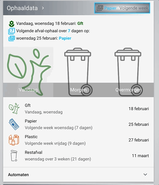

full stack showing like this
Feb-18-2026 10-04-39
Full card

                {% set dag = weekday(dagnummer|int) %}
                {% set unit = 'dag' if days == 1 else 'dagen' %}
                {% if days >= 28 %} {% set phrase = dag + ' over 4 weken' %}
                {% elif days >= 21 %} {% set phrase = dag + ' over 3 weken' %}
                {% elif days >= 14 %} {% set phrase = dag + ' over 2 weken' %}
                {% elif days >= 7 %} {% set phrase = 'Volgende week ' + dag %}
                {% elif days >= 3 %} {% set phrase = 'Komende ' + dag %}
                {% elif days == 2 %} {% set phrase = dag + ', overmorgen' %}
                {% elif days == 1 %} {% set phrase = 'Morgen, ' + dag %}
                {% else %} {% set phrase = 'Vandaag, ' + dag %}
                {% endif %}
                {{phrase}} {% if days != 0 %} ({{days}} {{unit}}) {% endif %}
              {% endif %}
