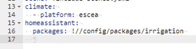

@sparkydave I am not really sure I have done this correctly.
I have a folder under config already called \config\custom_components\ that is where I have custom code for my fireplaces. Then under the confirguration.yaml I have a line entry
climate:
  • platform: escea
Can I just add another line here for yours? I went ahead and created a new folder called packages as indicated, I copied your code from above, put it into Sublime and saved it as irrigation.yaml. I moved it into the folder I created under \config\packages\irrigation.yaml
I added your code as you can see in the image, is this correct?
Also, once it is added, how do I add it as a component to the dashboard, is that the Lovelace code?
Lastly, this works directly with the RainBird LNK Wifi module right? I do not need any other hardware.
Thank you!

NO, This is NOT a custom_component, it’s just a package of yaml code.
No, you need to do it exactly as me example above.
This is not a component. You will need to edit the code in the irrigation.yaml file to suit your entity_id’s for the valves (switch entities).
