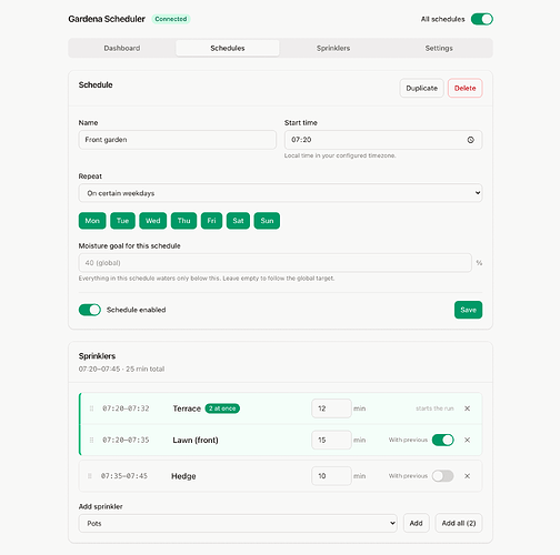

Start at 06:30, then run these sprinklers for these durations. That ordered list is the only thing stored — every clock time on the page is derived from it, and re-derived as you drag a row or change a number. Move the start time ten minutes later and the whole run moves with it.
  • Sprinklers can run together. Mark one to start with the previous and the group lasts as long as its longest member. A controller can hold at most two of its own valves open at once, so the editor refuses a third and names the two that clash rather than letting you find out at 06:00.
  • Weekdays, or every N days from an anchor date — a two-day cycle cannot be expressed as a weekday set, which is why both modes exist.

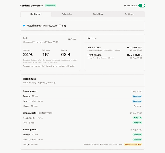

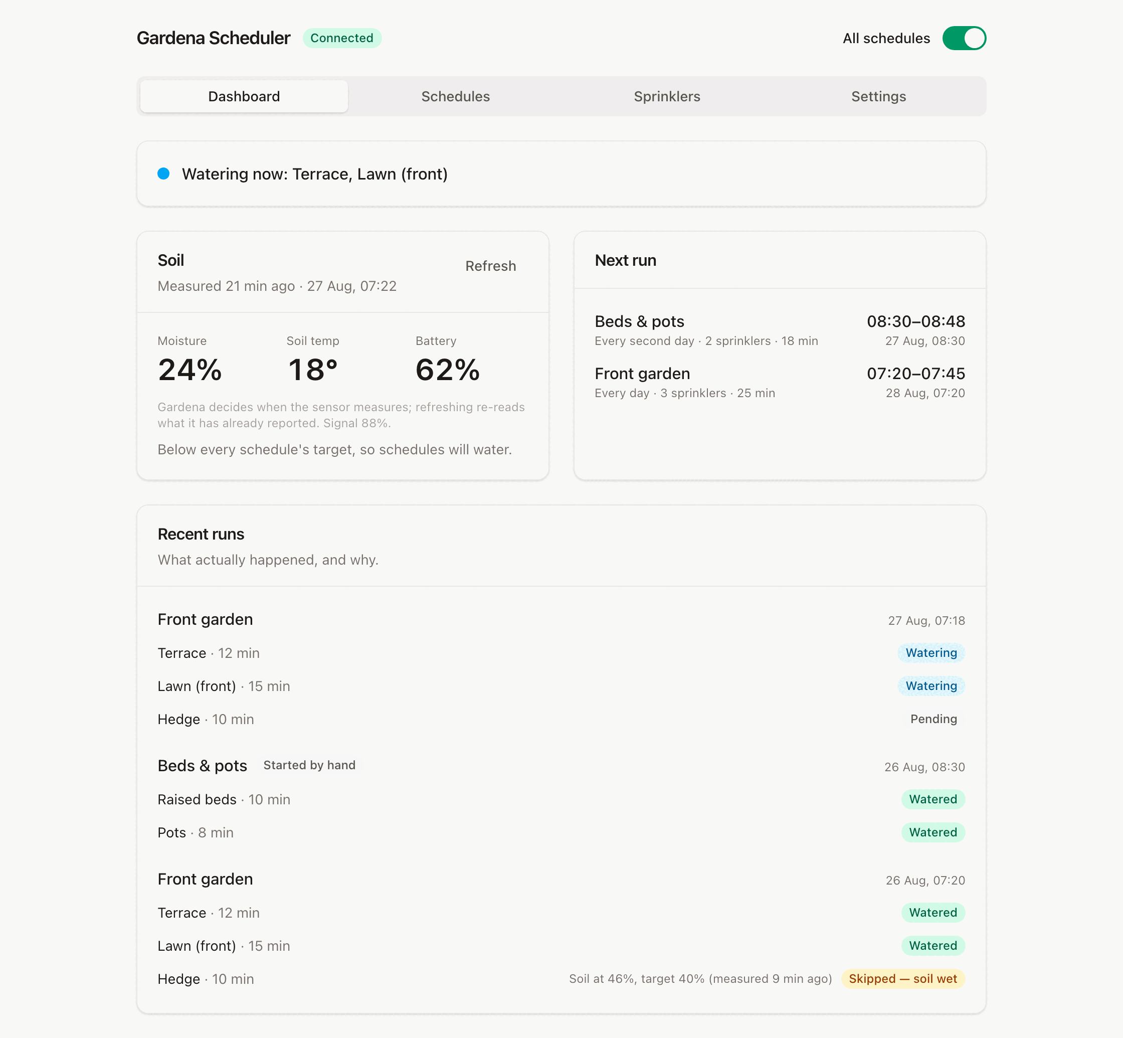

  • Skip watering when the soil is already wet, if you have a GARDENA smart Sensor. Targets can be set per sprinkler, per schedule or globally, and the most specific one wins, so a shaded bed can stay wetter than the lawn. It is re-checked before every sprinkler, so a long run reacts to the soil as it goes.
  • A stale reading waters anyway. Past an age you choose, a reading counts as unknown rather than as gospel. Watering an already-wet garden wastes one cycle; trusting a sensor that has quietly stopped reporting skips watering indefinitely while every run still looks healthy.

  • A run history that says why: what watered, what was skipped, and what the soil read at the time.

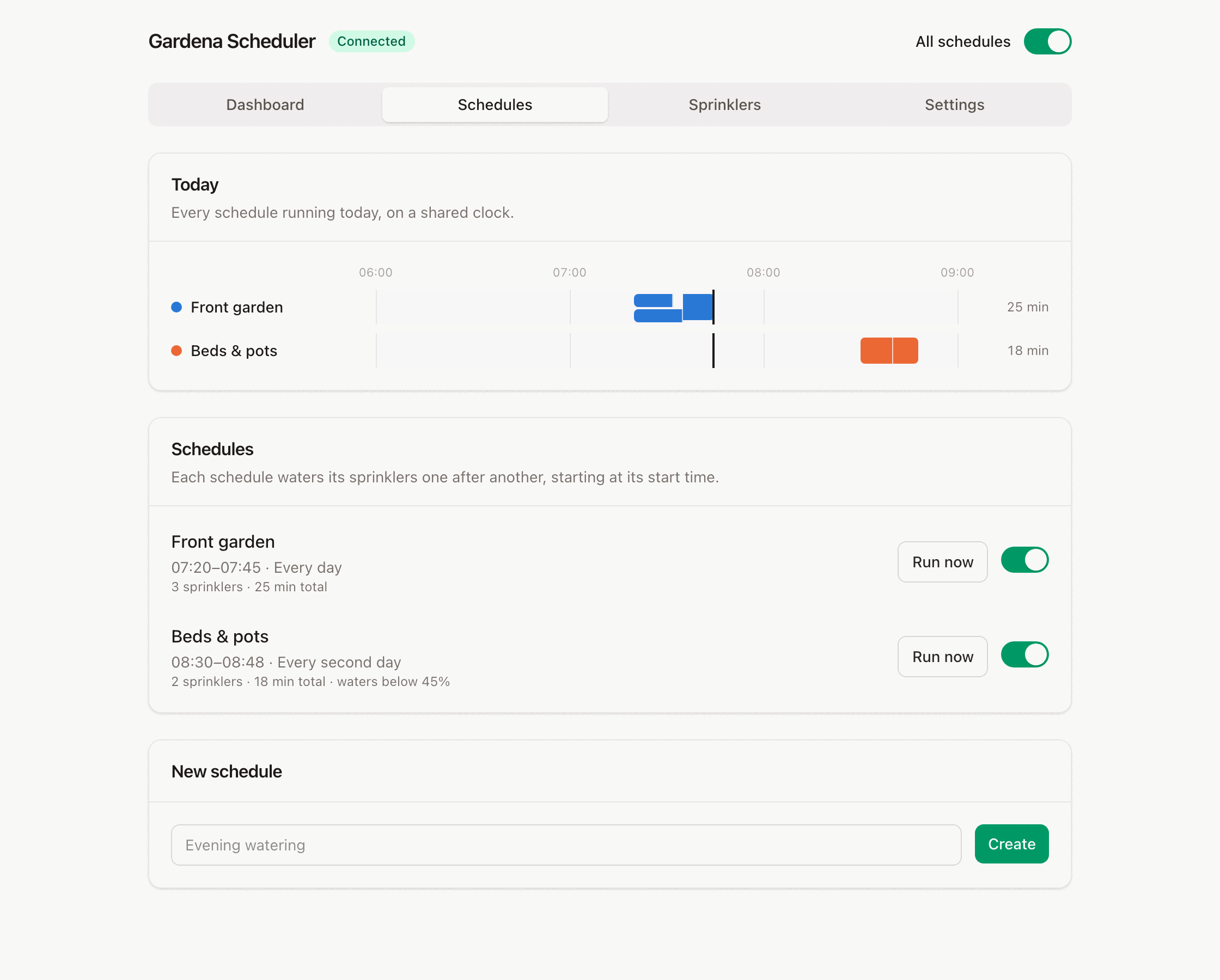

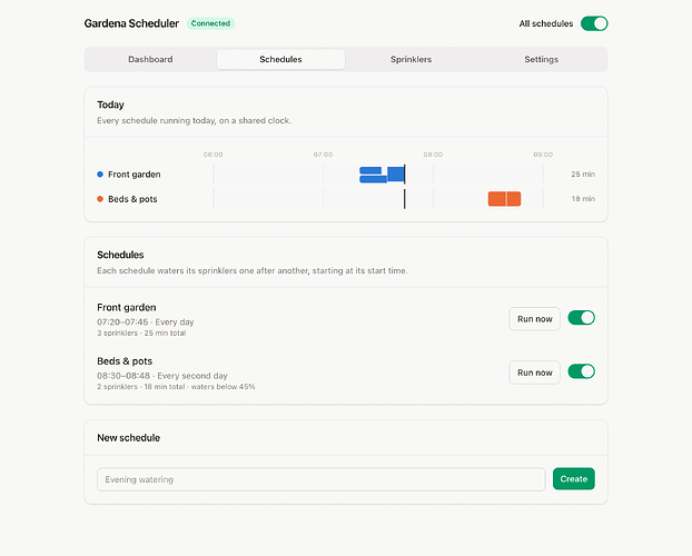

Only one schedule runs at a time, so everything due today is plotted on one clock and two schedules that overlap are flagged there — the second would be skipped for the day rather than queued behind the first.
