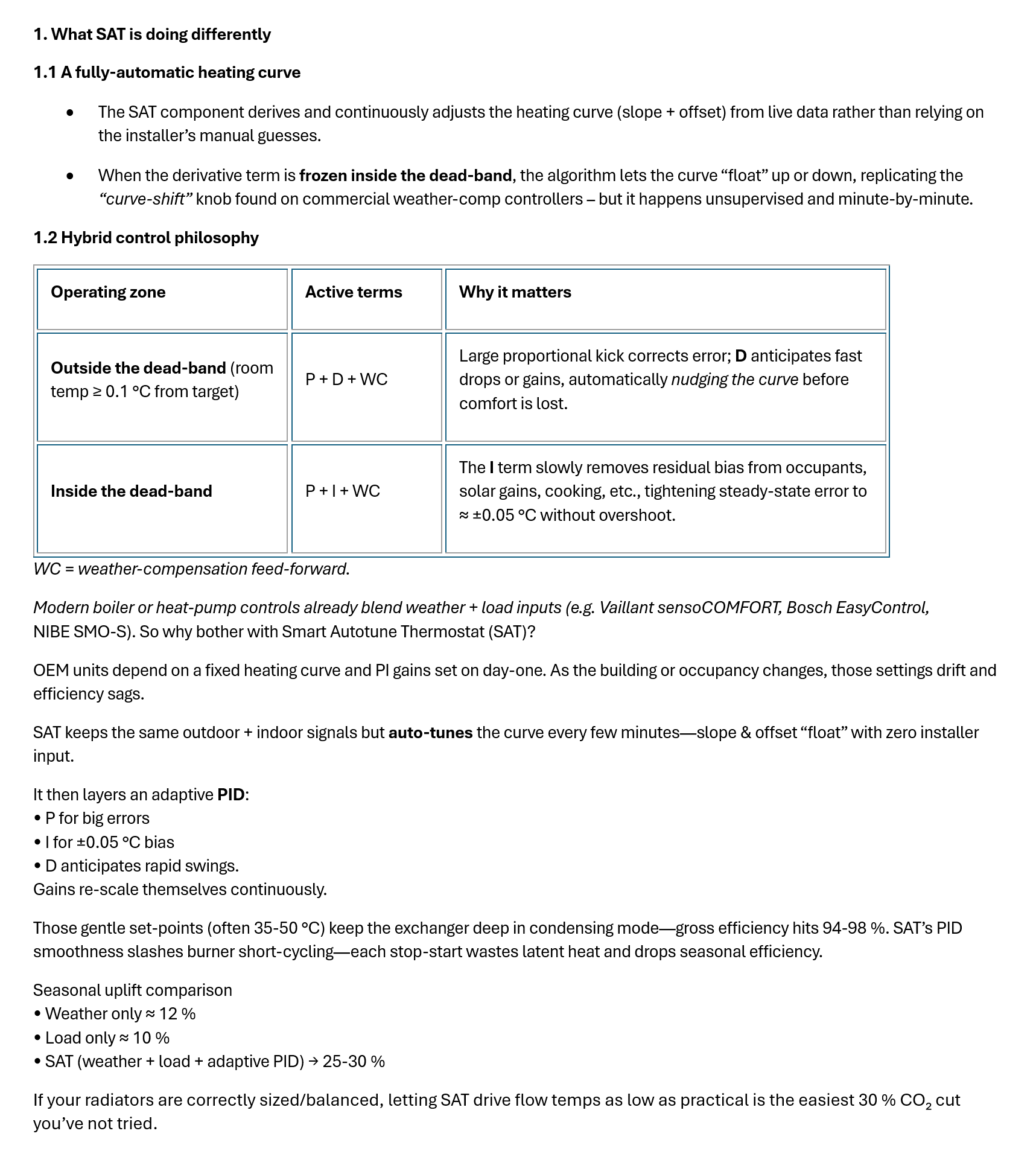

Your best bet is a gas boiler with OpenTherm which responds to MM=0 commands + minimum kW modulation below 4 kW and uses this integration [Custom component] Smart Autotune Thermostat - Share your Projects! / Custom Integrations - Home Assistant Community
