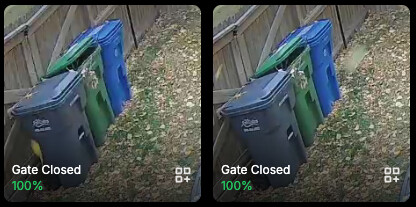

Yes, the next version of Frigate will be able to do this using classification models. I have one setup for my gate for example
