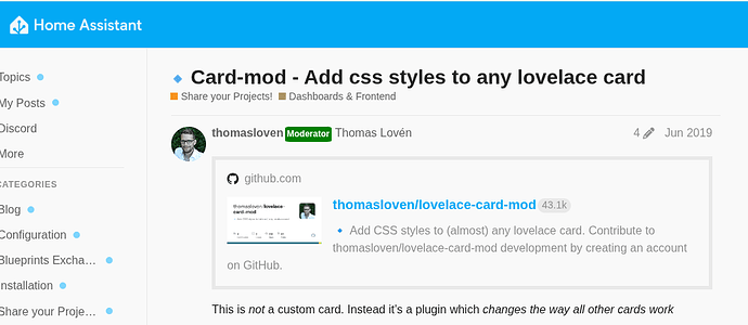

It is a beginner trying to find some logic in a sea of conflicting, jumbled-up and miss-spelled threads. I am genuinely grateful to all who are trying to help. My problem here, is that advice being given is little vague and what I am finding does not match with what I would expect. For example, I assume that the link to “main cardmod [sic] thread” is this:

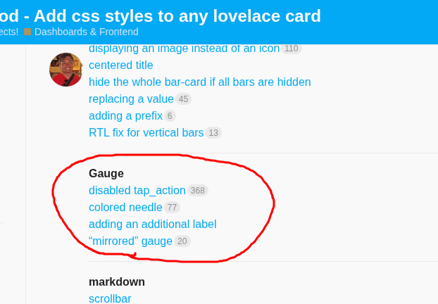

Then search for “Guage”, and the examples that are suggested are these:
Unfortunately (as far as I can see), none of those four show example of:
