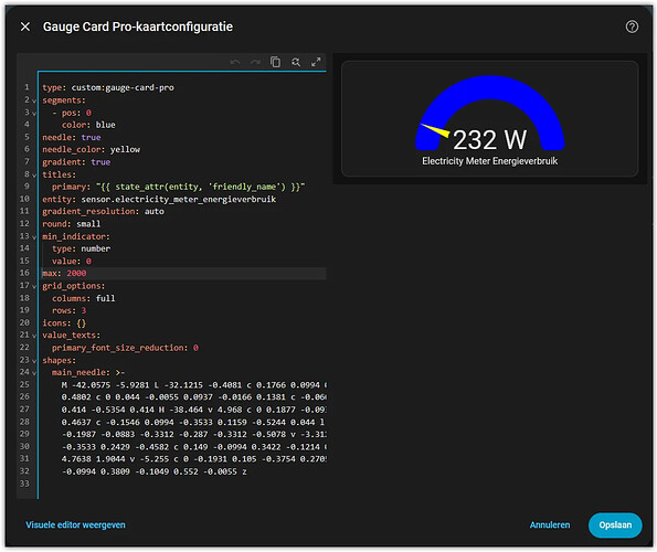

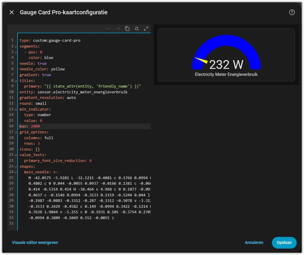

Hi Miura,
How can i set the min/max or setpoint indicator? I’ve tryd min_indicator: 1

For the min/max indicator the following parameters are currently added:
label (boolean)
label_color (string)
precision (number)
For setpoint the following are added:
label (boolean)
precision (number)

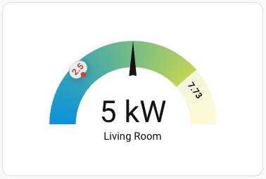

I’m just asking, if possible, that when clicking on the secondary entity, it opens the record of that entity.
For example, if I have a gauge with the temperature in the main entity and the humidity in the secondary entity, it would be good if, when clicking there (marked in the image), it opened the humidity record instead of the temperature record!
Other than that, it’s perfect for me!
Miura
January 16, 2026, 3:43pm
185
That’s already supported. Checkout the interactions menu within the Visual Editor (or in the manual). You want to configure the ‘secondary value text’. You can set it to ‘more-info’ which will use ‘entity2’ automatically or configure an custom entity

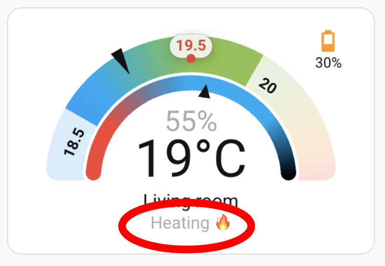

Hello guys, I need your help because I am trying to add the circled item. I would like that, when an entity is OFF, it is showed(as the example) saying HEATING like in the example; and when that entity is ON, the title dissapears
The entity name is light.colector_hall_cocina
This is my actual yaml code for the card:

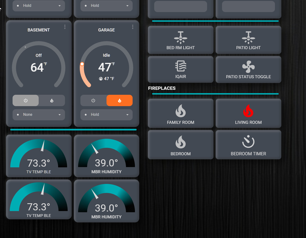

Im wondering if its possible to make the graph smaller. Im trying to use custom mod settings. The card is simply too big and changing the height will make the card smaller but not the graph. Other cards have a radius setting or simply a size
This is what happens when I have the height to 80px.
These cards are way to big compared to the rest of my cards on the dashboard.
Thanks for your help on an amazing project

Miura
February 4, 2026, 7:29pm
188
Something like this:
titles:
primary: Living room
secondary: |-
{% if is_state('light.colector_hall_cocina', 'off') %}
Heating 🔥
{% endif %}

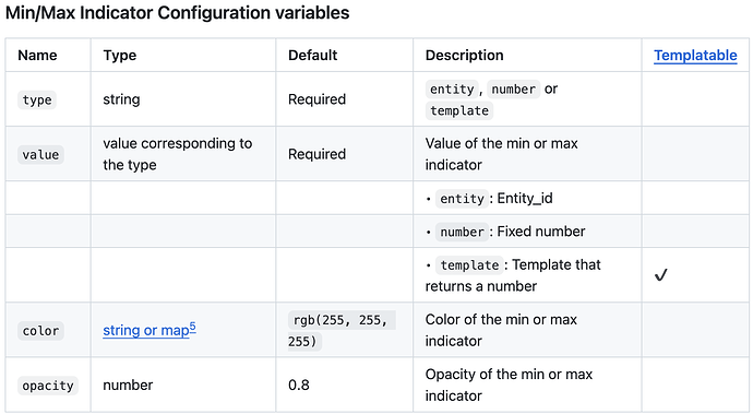

I have just found your card. It is amazing, thank you so much! But I’m struggling with a template in the max indicator of the inner gauge. It seems broken, here is the full code of my card:
type: custom:gauge-card-pro
entity: sensor.pws_wind_speed
segments:
- from: 0
color: green
- from: 15
color: yellow
- from: 25
color: red
needle: true
gradient: true
titles:
primary: "{{ state_attr(entity, 'friendly_name') }}"
entity2: sensor.pws_wind_gust
icons: {}
max: 40
min: 0
round: small
severity_centered: false
gradient_background: false
max_indicator:
type: template
value: |-
{% if is_state('automation.toldos_registrar_viento_maximo', 'on') %}
{{ states('input_number.toldos_viento_maximo_registrado') | float }}
{% else %}
{{ 100 }}
{% endif %}
opacity: 0.5
color: black
label: true
min_indicator:
type: template
value: |
{% if is_state('automation.toldos_registrar_viento_minimo', 'on') %}
{{ states('input_number.toldos_viento_minimo_registrado') | float }}
{% else %}
{{ 0 }}
{% endif %}
color: black
opacity: 0.5
inner:
mode: needle
min: 0
max: 40
segments:
- from: 0
color: green
- from: 15
color: yellow
- from: 25
color: red
round: small
gradient: true
gradient_resolution: auto
max_indicator:
type: template
color: black
opacity: 0.5
value: |-
{% if is_state('automation.toldos_registrar_rafagas_maximas', 'on') %}
{{ states('input_number.toldos_rafagas_maximas_registradas') | float }}
{% else %}
{{ 100 }}
{% endif %}
The max_indicator of the inner is not showing. I have even tried this:
max_indicator:
type: template
color: black
opacity: 0.5
value: |-
{{ 10 }}
But nothing shows. However with entity type, it works fine:
max_indicator:
type: entity
color: black
opacity: 0.5
value: input_number.toldos_rafagas_maximas_registradas
I need the template, because the input_number is not refreshing until I enable the automation. Any comments will be appreciated!
Miura
March 16, 2026, 7:36pm
194
It’s broken. Will fix it in an upcoming release
