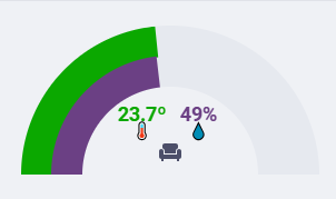

Hello there!
I love your Card, thank you!
It is possible to put a mdi icon instead of plain text in the Titles camp?
Like the one I attached. That is from dual-gauge-card.
Thank you!
Hello! Thanks for your reply.
But what I want to do is replace the text I marked in red and still see both values ​​(temperature and humidity).
I assume that doesn’t work… can you add that feature?

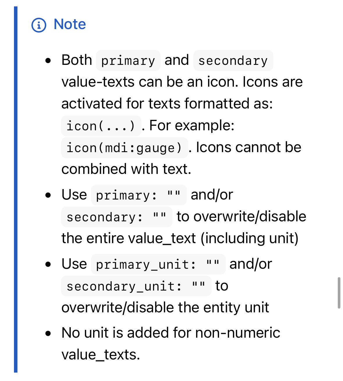

That text indeed cannot be an icon. I feel it’s better to have the icons inside the gauge and than template the title(s) to show the values.

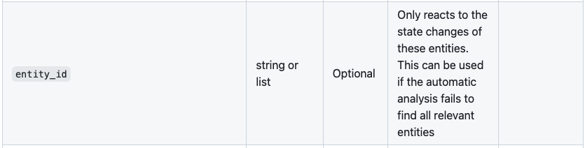

I’m using an entity within the label of an icon, but the value of the entity is not updating like the value text.

This indeed seems to happen sometimes. You can use entity_id to supply the entity or a list of entities that should help trigger updates

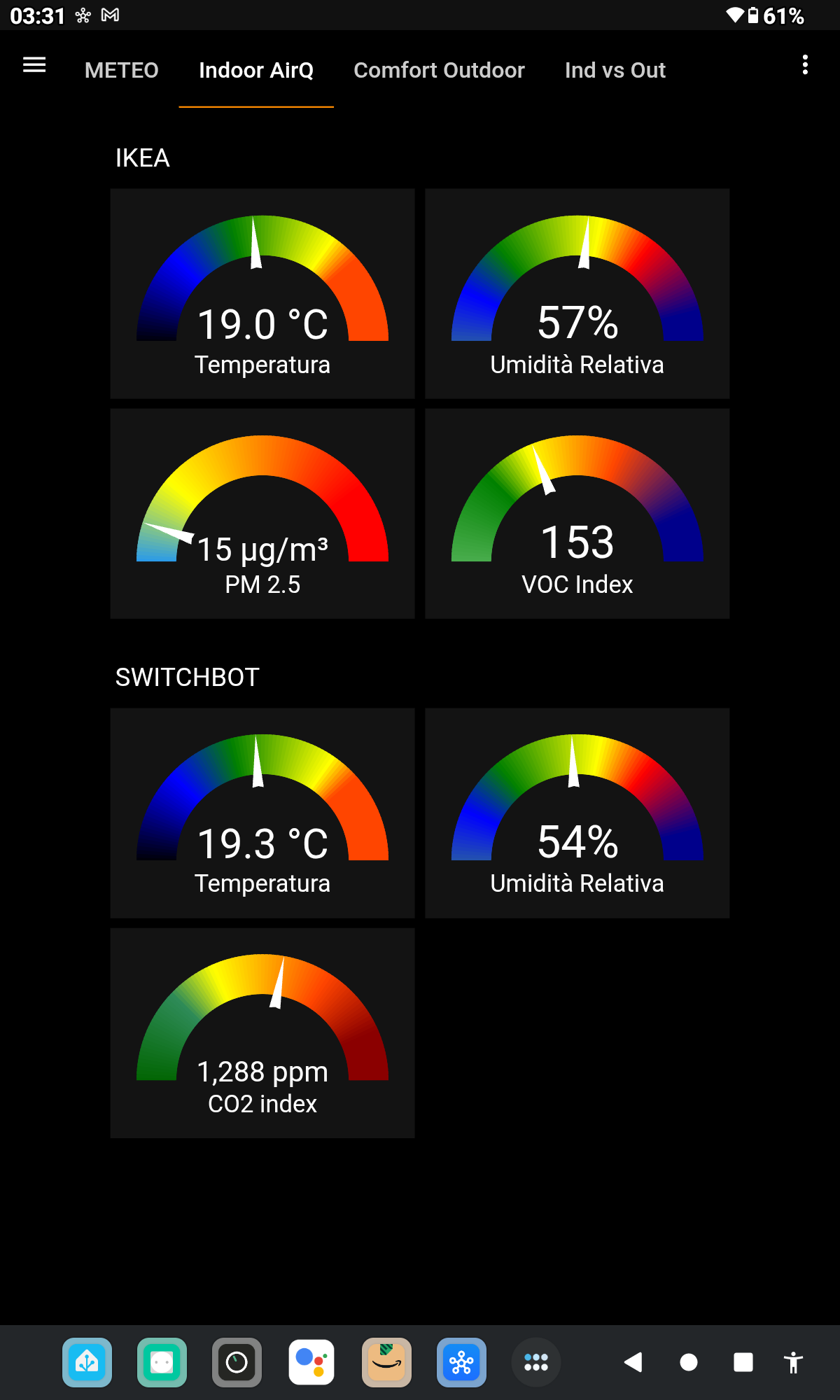

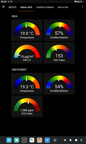

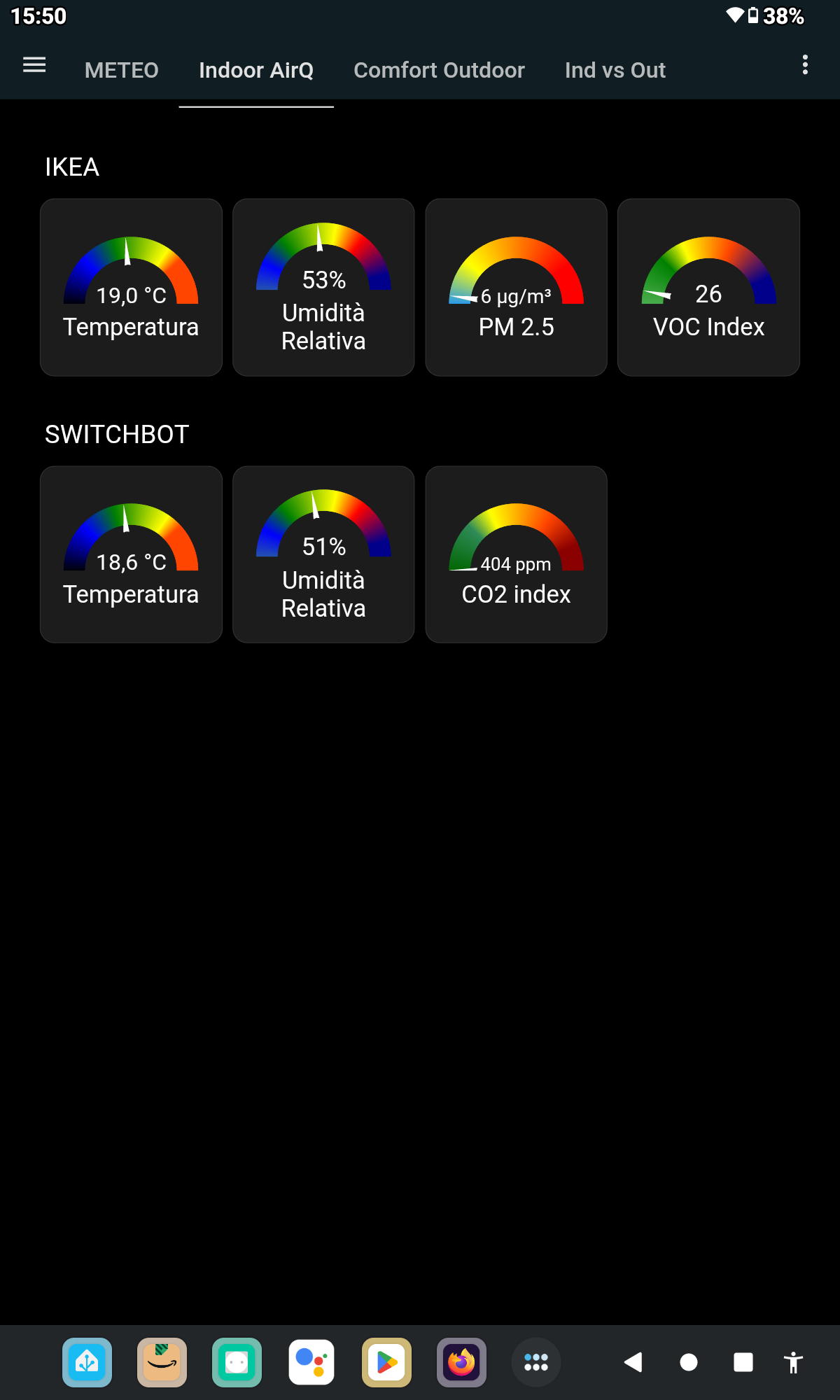

after updated to 2025.12, on my android Tablet (11" display) i have this view
( exmple i have tens of your wonderful cards in different views dash)
Config still be the same from several montths::
the first with little image is After done update, 2nd is previous before
It seems from my view:
with this release there are a lot of BIG changes in Companion App,
resizing from PC to Android or viceversa is completely lost
Thanks in advance for your reply
I don’t think that’s something I (can) control. It seems more related to your dashboard configuration. Try to look for things like section width for example

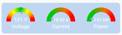

I’m probably overlooking this somewhere… but I’ve not found a key or another way to change the background color of the card. I can hide the background, sure… but change the color? Would it require embedding this card with a hidden background in another card that has a background color?
EDIT: In the meantime, I just dropped three gauge pro cards into a horizontal stack:
I indeed don’t have native support for background colours. With card-mod you should be able to achieve this.
