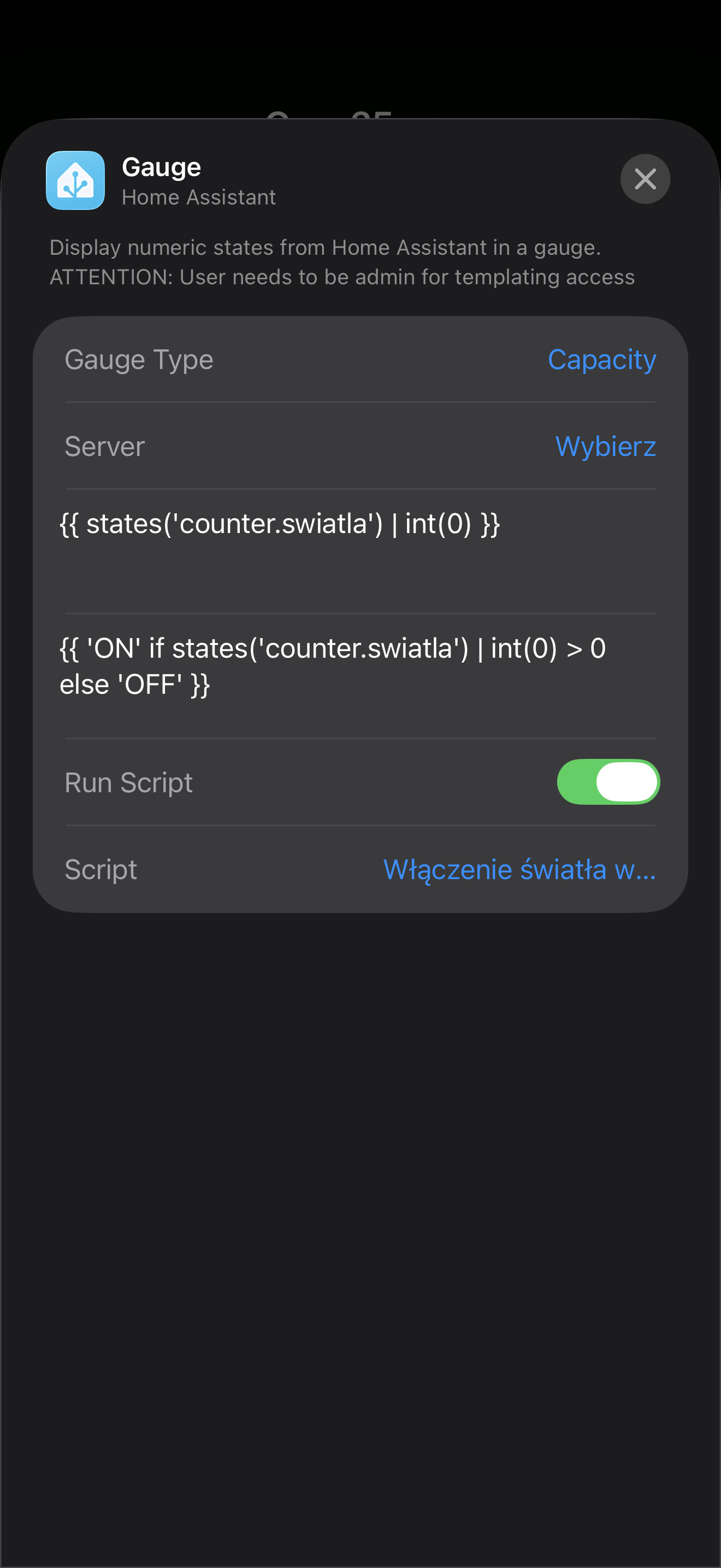

I need help with setting up a gauge widget on iPhone.
I have Govee lights and I use a script to turn them on or off based on a counter:
  • 0 → lights off
  • 100 → lights on
I want to create a gauge widget that:
  • shows the current light status
  • runs the script when clicked
Script Logic
If counter value is higher than 0.1
lights off
set counter to 0
else
lights on
set counter to 100
Notes
  • Light usage is based on actions made in the Govee app
  • The gauge can show:
    • On / Off, or
    • 0 or 1 (if needed)
I think you are looking for a switch
I was looking to for the gauge widget configuration and was able to accomplish it with setup below. With some trying and chat gpt it came out how I wanted it.
