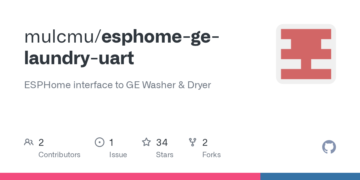

ESPhome based option:

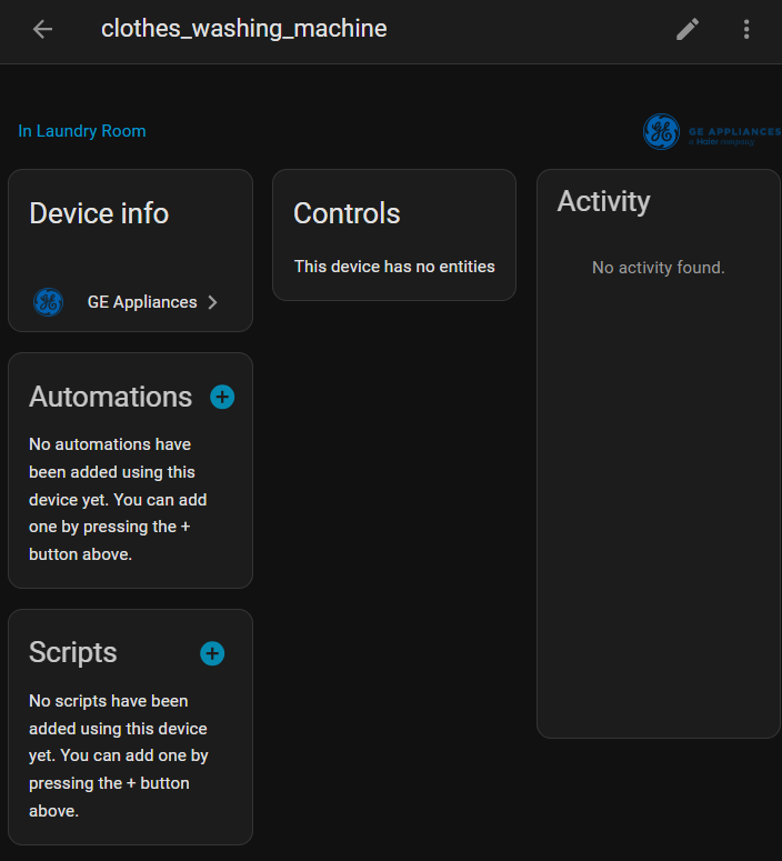

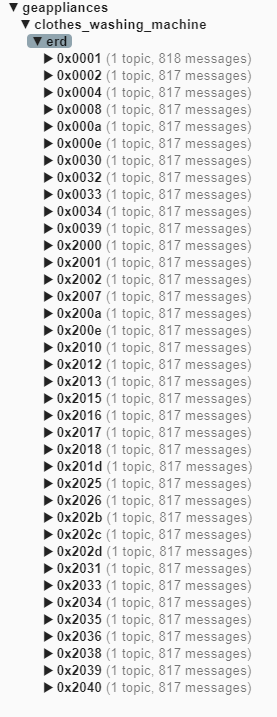

Do you know if the integration is compatible with the GEA2 adapter code?
I have that code running and populating my MQTT broker with info, and the integration sees the topic and has created a device, but doesn’t create any entities.
EDIT: Things have improved. See response from @mekaneck below
The answer is ā€œnot reallyā€. The current GEA2 adapter code can only read from appliances. It cannot write to them.

Well I have a bit of an update on my progress - I’ve actually been successful in getting my GEA2 washing machine connected and also able to write certain ERD’s!
The GE folks were kind enough to help me out in an issue I posted on the HA integration here.
The GEA2 adapter code does already support writes, and I was able to manually publish a GEA3 API feature manifest to MQTT (with a retain flag) which causes the HA integration to create some entities automatically, including writable ones.
I’m planning to test out whether I can modify the integration’s manifest json file to see if I can get additional entities supported, but that will have to wait for the holidays when I should have some free time.
But, in short, even if you don’t use the HA integration and elect to write the YAML to create the entities, it is possible to create writable entities, but you’d have to know how to configure them up front.
