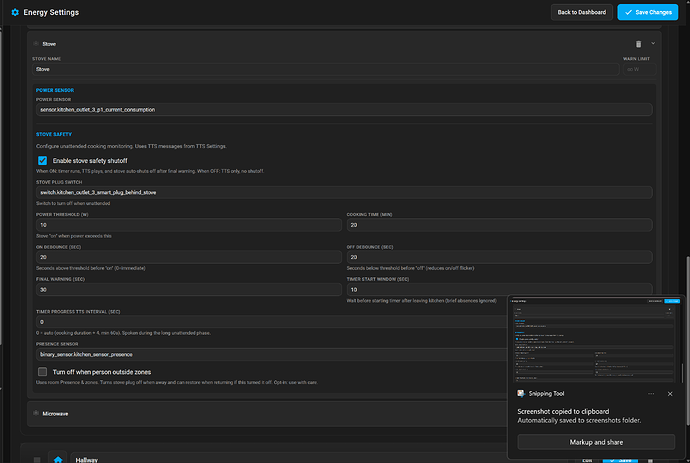

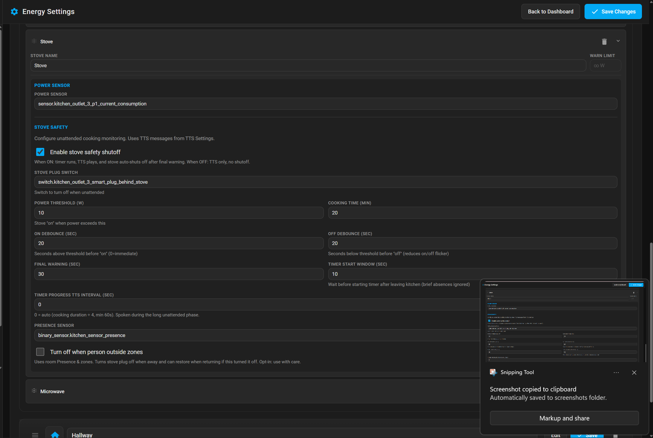

sounds interesting the least, wonder what controls it gives a stove, was in the works of developing DIY smart knobs to turn off stoves. Current setup is if stove on 20min and no presence shut it off (with auto timer/tts intervals/restart logic) as its fucking easy to forget electric stove on and seriously run that bill high
(part of huge project soon to release)
After taking deep dive into this, the community will benefit more from keeping this fully opensource (premade devices are cool) but the software on them could get a bunch of free labor hours from a guy like me :slight_smile: this project peaked my interest greatly. Whilst it truely does offend me to see anything for sale in the slightest of way on this forum i do understand

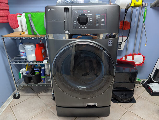

Hi! I just bought the FirstBuild Home Assistant Adapter to hopefully replace my current cloud-based GE Home integration with local control.

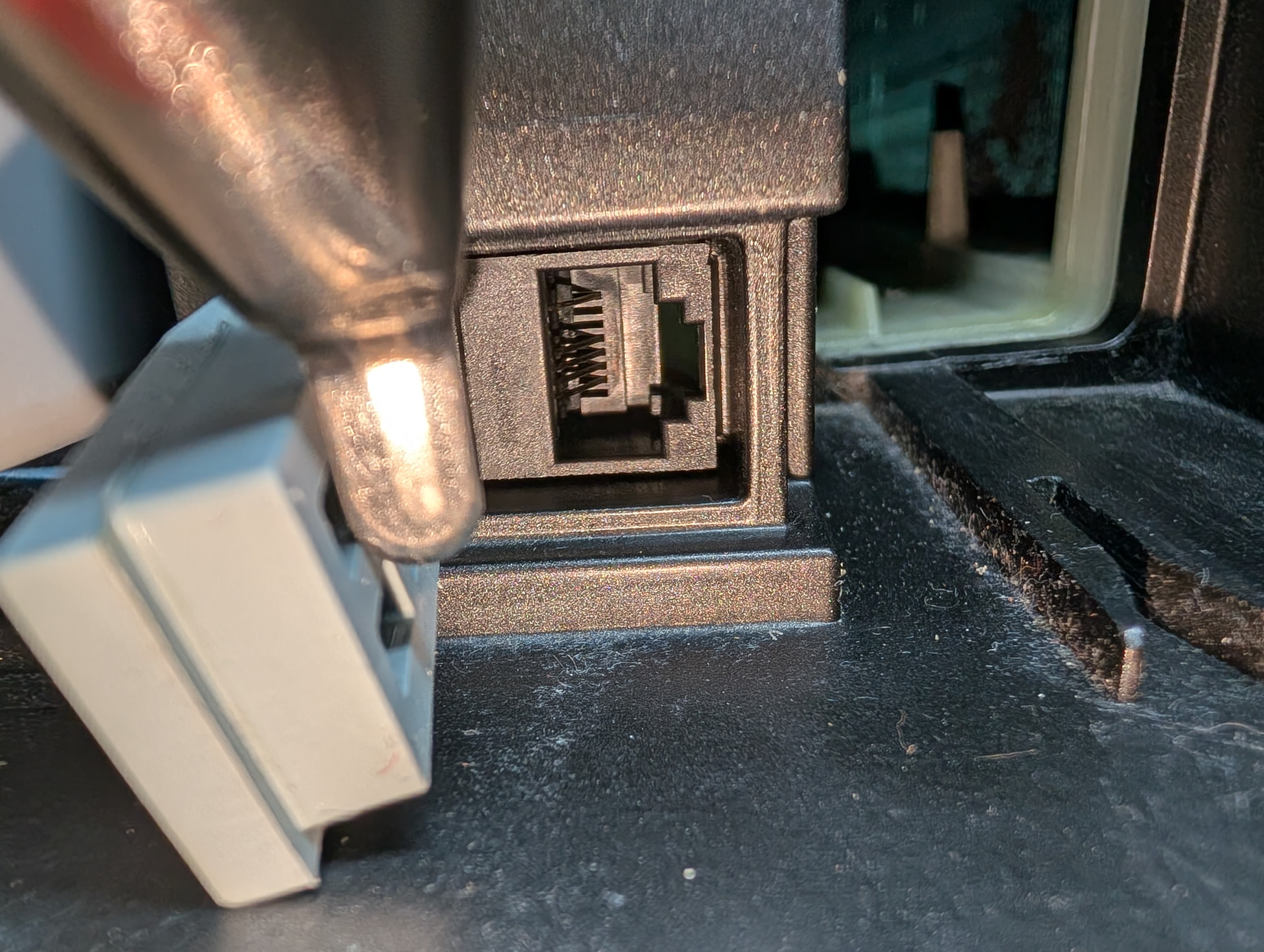

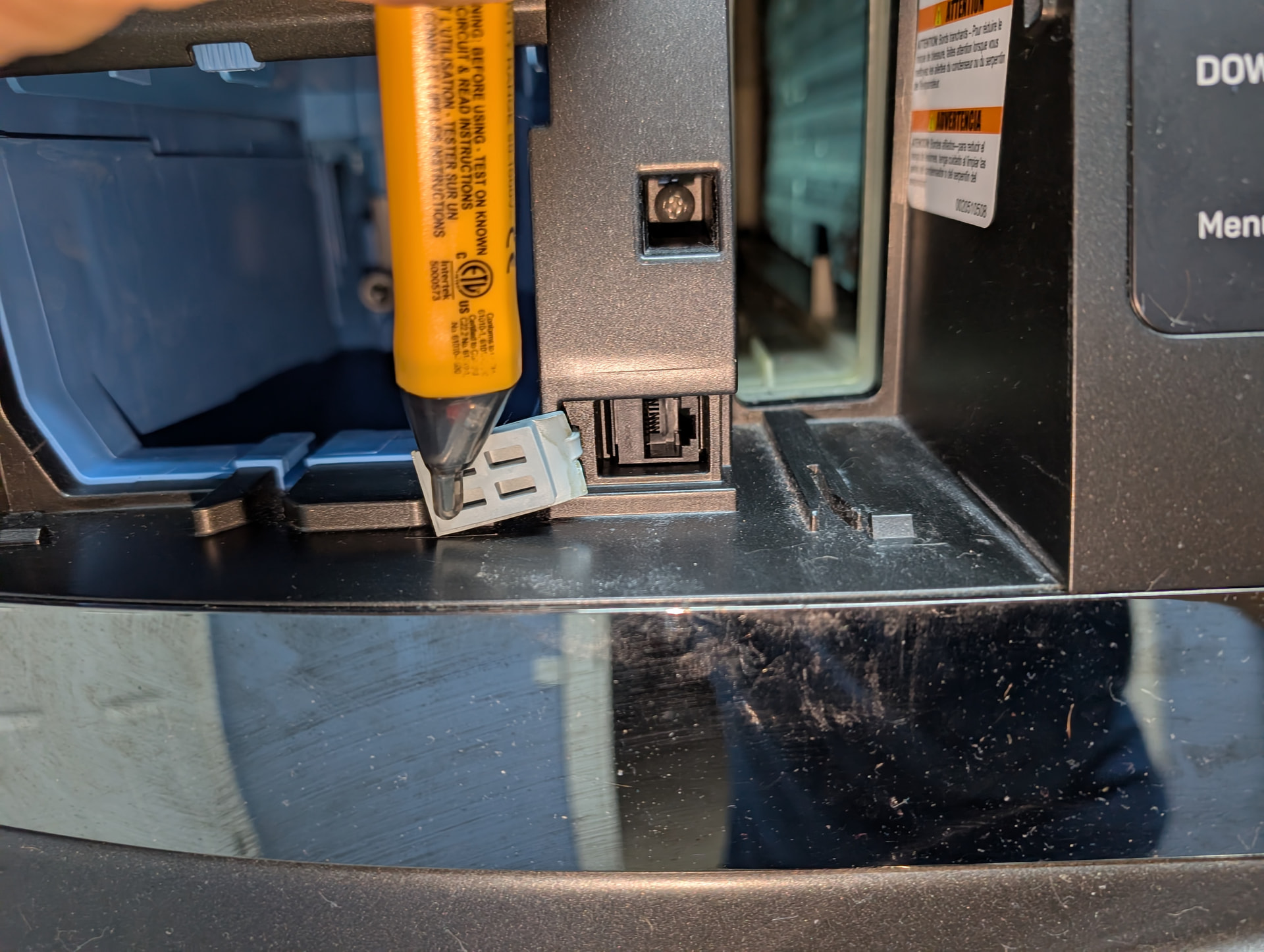

My appliance is a GE Profile UltraFast Combo Washer/Dryer, model PFQ97HSPV0DS (ventless heat pump technology, front-load combo unit). I've confirmed the unit has an accessible RJ45 diagnostic port (see pics).

Thanks for the confirmation! I went ahead and got it working and wanted to share my results for anyone else with a PFQ97 combo unit wondering if it's worth trying.
The adapter connected immediately and populated 122 ERD topics right out of the box with no custom mapping needed. The GE Appliances integration in HACS handled entity discovery automatically. I'm getting full visibility into machine state, subcycle phases, water temperature, basket RPM, water level, smart dispense status, energy usage and cycle options, all completely local. :partying_face:
For reference I flashed the standard PlatformIO firmware and it was pretty straightforward once VS Code and MQTT Explorer were set up. That said, the ESPHome firmware posted above looks like a much easier path for most HA users and I'd suggest starting there if you're just getting going.
I also printed the enclosure from the STL files in the Git repo. I had some filament that closely matched the light blue on the unit. I ran a thin ethernet cable from the front (under the fabric softener dispenser drawer) to behind the machine, and it turned out really nice.
Bottom line for anyone with a PFQ97: don't let the missing compatibility listing stop you. If the RJ45 port is accessible, it works.
