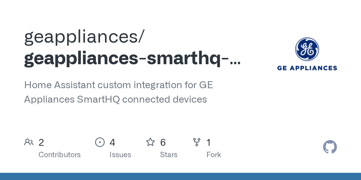

I delete this integration and use that one instead
Oh nice, thank you! Hopefully it supports my Dishwasher! I'll try this out this week.

I was glad to see the more official repo mentioned here. Not sure I'll spend time to switch, as I really want to pursue all-local (non-cloud) integration, as is being discussed elsewhere on forum.
I have 5 GE appliances: washer, dryer, range/oven, fridge, dishwasher. Three use the 'simbaja' integration above. One uses an official GE FirstBuild adapter & integration, which is all-local --from official GE source! Fifth one (fridge) uses GEA2 protocol, so I'm working w/ a different ESPHome device on that --all-local, of course.
