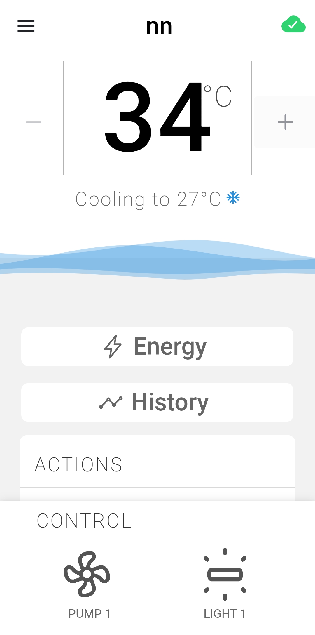

I have connected in.touch3 that is newest version of remote control by Gecko. Anyone tried to integrate in.touch3 to homeassistant? integration for intouch2 cannot detect intouch.3. Thank you in advance.
Looks like the in.Touch 3 adds some new security, and it will possibly never be supported. I ordered a spare in.Touch 2, while they are still easy to find.

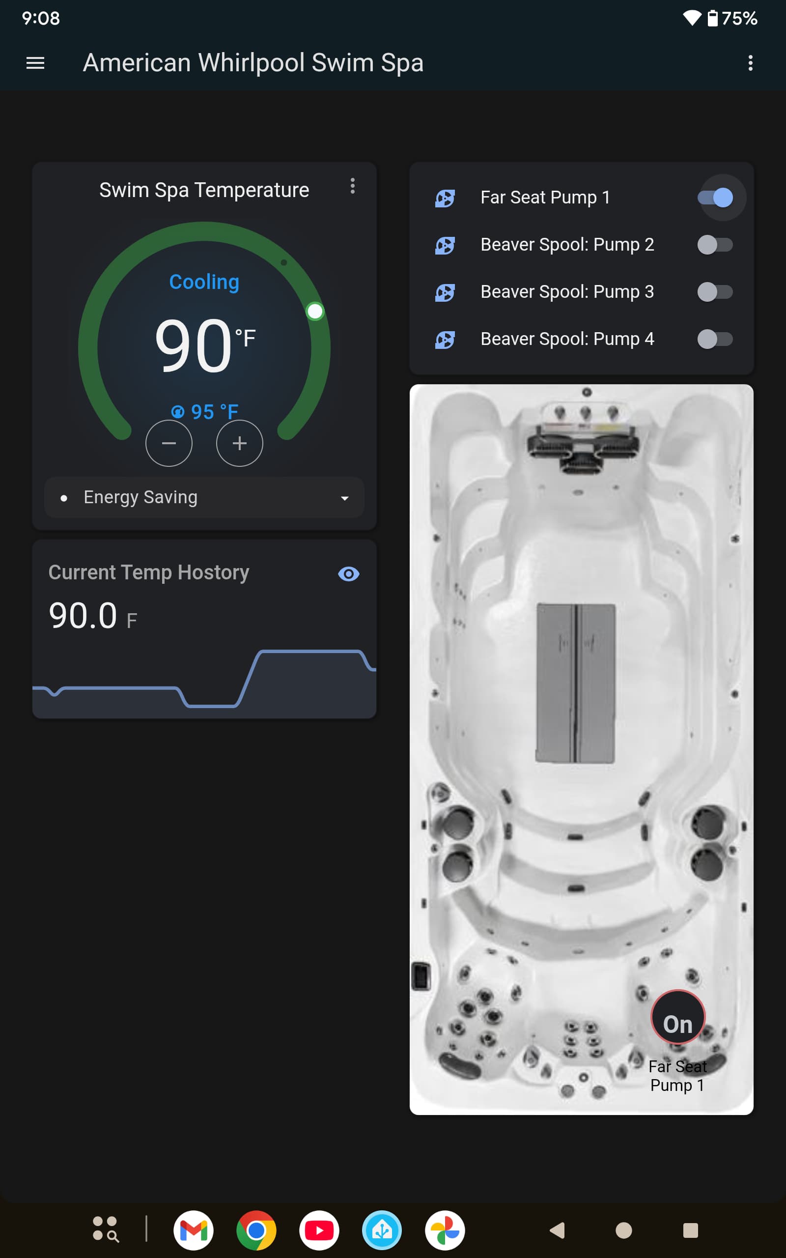

I’ve been working on a dashboard for my spa. I’m having problems with adding a drop-down to select external heat for my gas heater in the winter and electric heat in the summer. I also want to add buttons for low and high for the pumps on the layout image of the spa since I always forget what pump shoots out where. I’m new to HA so the cards are losing me somewhat. P.S. this is my first post here as well… I’m super new

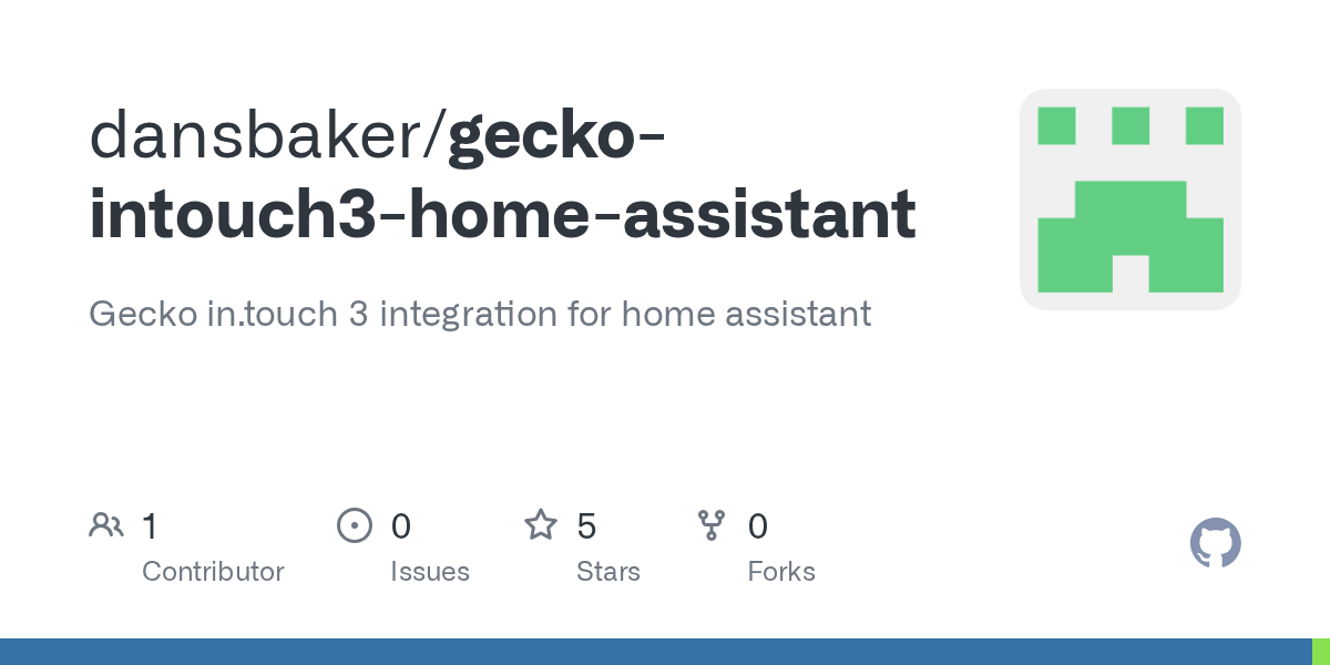

For those who come here and look for in.touch3 support there is now an integration for it.
