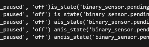

Error while processing template: Template<template=({% if is_state('binary_sensor.pending_updates', 'on') and states('sensor.pending_updates')|int(0) > 15 and is_state('binary_sensor.updates_paused', 'off') %}red {% elif is_state('binary_sensor.pending_updates', 'on') and states('sensor.pending_updates')|int(0) > 15 and is_state('binary_sensor.updates_paused', 'on') %}orange {% elif (is_state('binary_sensor.updates_paused', 'off')is_state('binary_sensor.pending_updates', 'on') and is_state('schedule.update_system', 'on')) or states('sensor.pending_updates')|int(0) > 10 or is_state('update.home_assistant_core_update', 'on') or is_state('update.home_assistant_operating_system_update', 'on') or is_state('update.home_assistant_supervisor_update', 'on') %}orange {% elif is_state('binary_sensor.pending_updates', 'on') %}blue {% else %}green {% endif %}) renders=2>
Error while processing template: Template<template=({% if is_state('binary_sensor.pending_updates', 'on') and states('sensor.pending_updates')|int(0) > 15 and is_state('binary_sensor.updates_paused', 'off') %}red {% elif is_state('binary_sensor.pending_updates', 'on') and states('sensor.pending_updates')|int(0) > 15 and is_state('binary_sensor.updates_paused', 'on') %}orange {% elif (is_state('binary_sensor.updates_paused', 'off') is_state('binary_sensor.pending_updates', 'on') and is_state('schedule.update_system', 'on')) or states('sensor.pending_updates')|int(0) > 10 or is_state('update.home_assistant_core_update', 'on') or is_state('update.home_assistant_operating_system_update', 'on') or is_state('update.home_assistant_supervisor_update', 'on') %}orange {% elif is_state('binary_sensor.pending_updates', 'on') %}blue {% else %}green {% endif %}) renders=2>
Error while processing template: Template<template=({% if is_state('binary_sensor.pending_updates', 'on') and states('sensor.pending_updates')|int(0) > 15 and is_state('binary_sensor.updates_paused', 'off') %}red {% elif is_state('binary_sensor.pending_updates', 'on') and states('sensor.pending_updates')|int(0) > 15 and is_state('binary_sensor.updates_paused', 'on') %}orange {% elif (is_state('binary_sensor.updates_paused', 'off') ais_state('binary_sensor.pending_updates', 'on') and is_state('schedule.update_system', 'on')) or states('sensor.pending_updates')|int(0) > 10 or is_state('update.home_assistant_core_update', 'on') or is_state('update.home_assistant_operating_system_update', 'on') or is_state('update.home_assistant_supervisor_update', 'on') %}orange {% elif is_state('binary_sensor.pending_updates', 'on') %}blue {% else %}green {% endif %}) renders=2>
Error while processing template: Template<template=({% if is_state('binary_sensor.pending_updates', 'on') and states('sensor.pending_updates')|int(0) > 15 and is_state('binary_sensor.updates_paused', 'off') %}red {% elif is_state('binary_sensor.pending_updates', 'on') and states('sensor.pending_updates')|int(0) > 15 and is_state('binary_sensor.updates_paused', 'on') %}orange {% elif (is_state('binary_sensor.updates_paused', 'off') anis_state('binary_sensor.pending_updates', 'on') and is_state('schedule.update_system', 'on')) or states('sensor.pending_updates')|int(0) > 10 or is_state('update.home_assistant_core_update', 'on') or is_state('update.home_assistant_operating_system_update', 'on') or is_state('update.home_assistant_supervisor_update', 'on') %}orange {% elif is_state('binary_sensor.pending_updates', 'on') %}blue {% else %}green {% endif %}) renders=2>
Error while processing template: Template<template=({% if is_state('binary_sensor.pending_updates', 'on') and states('sensor.pending_updates')|int(0) > 15 and is_state('binary_sensor.updates_paused', 'off') %}red {% elif is_state('binary_sensor.pending_updates', 'on') and states('sensor.pending_updates')|int(0) > 15 and is_state('binary_sensor.updates_paused', 'on') %}orange {% elif (is_state('binary_sensor.updates_paused', 'off') andis_state('binary_sensor.pending_updates', 'on') and is_state('schedule.update_system', 'on')) or states('sensor.pending_updates')|int(0) > 10 or is_state('update.home_assistant_core_update', 'on') or is_state('update.home_assistant_operating_system_update', 'on') or is_state('update.home_assistant_supervisor_update', 'on') %}orange {% elif is_state('binary_sensor.pending_updates', 'on') %}blue {% else %}green {% endif %}) renders=2>

You have syntax errors in that template. Without seeing the formatted template, it’s hard to help.
From what I can see, you’re missing a space between an and and is_state.
@petro is a master at templating, so listen to him.
I absolutely suck at templates, but even I can see that there are multiple typos & syntax errors in the code you posted:
  • First row is missing a space and and
  • Second row is missing and
  • Third row should be and is_state, not ais_state
  • Fourth row should be and is_state, not anis_state
  • Fifth row should be and is_state, not andis_state
