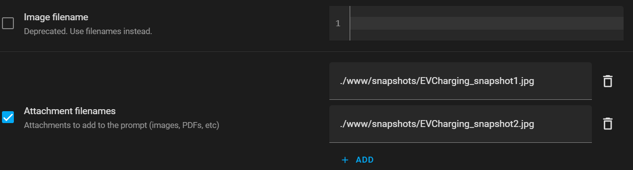

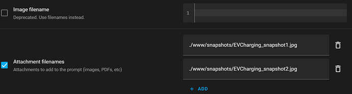

Since recent HA 2025.3.0 update I get this message:
The ‘image_filename’ parameter in Google Generative AI actions is deprecated. Please edit scripts and automations to use ‘filenames’ intead.
Yes, I just resolved this today. Just move the file names from image filenames to attachment filenames.
filenames works now in 2025.3.1
Is there a way to modify this to pull images from 2 cameras (from 2 different angles) to compare and describe? only seeing the one snapshot in the notification is fine.
