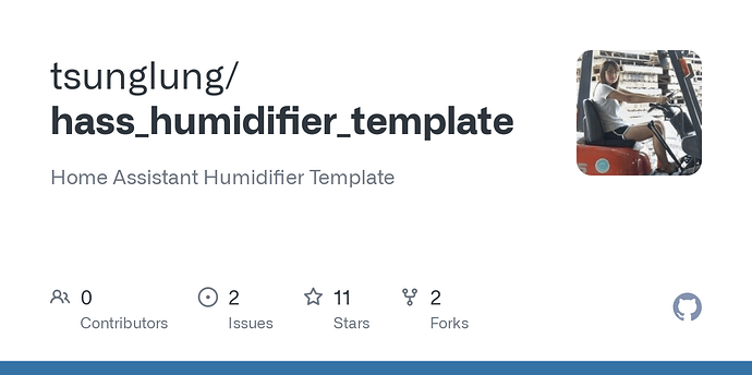

With this you have a fully templateable humidifier/dehumidifier:
Home Assistant Humidifier Template

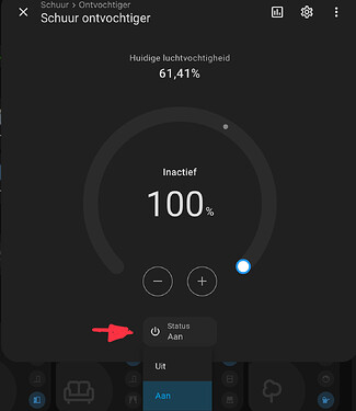

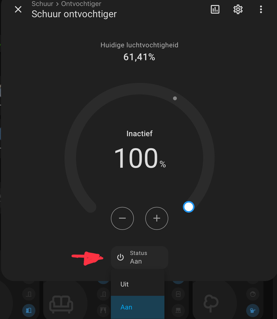

However, doesn’t the generic hygrostat have an on/off state for you? it does for me:
This is the answer.
I didn’t see the On/Off control on the main card.
