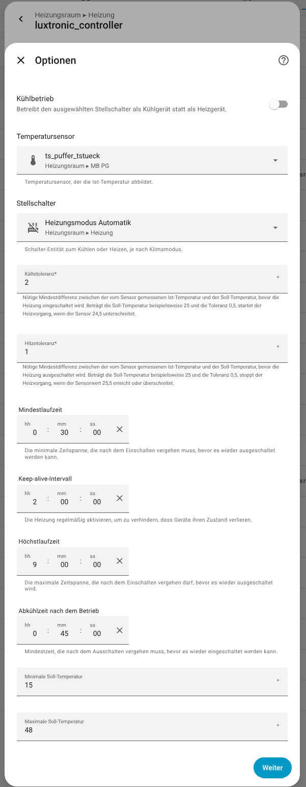

Background: I’m using the generic thermostat from the helpers to consolidate the control of a heat pump. Target temperature is fed via an automation from a function dependent on the outside, thus the target temperature does change quite often. Heat pump is controlled via change of automatic mode. As heat pumps don’t like short turn-on too much, I set the minimum run time to 30 minutes. Hysteresis is set to approx +/-2 K.

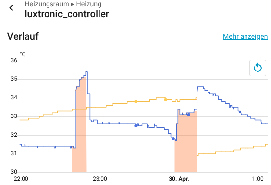

Observed behavior: The running time is sometimes shorter than 30 minutes (See pic). Guess from my side: Either a Change of the target-temp or crossing the upper threshold have precedence over the minimum running time. As from the pic the turn-off coincidences pretty good with the target change (yellow curve), first seems to be more likely.
What I would expect: Minimum runtime will be followed when target-temp changes and threshold-crossing but shall be canceled if the thermostat is restarted or the mode is changed.

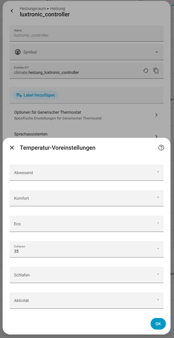

You should be able to look at the options on the helper itself in the more info window.
You’ll have to take screenshots.

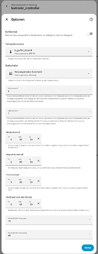

But here
it is
