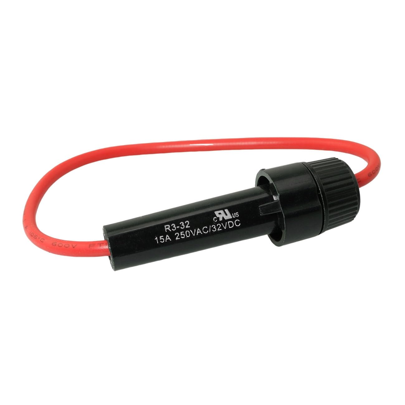

Or simply use an inline 120v fuse - even simpler. something like this:
