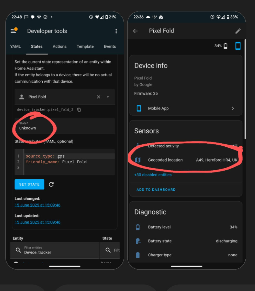

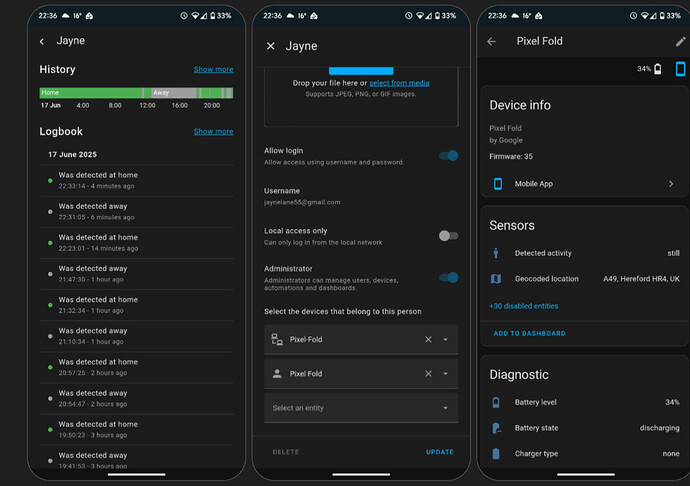

Basically, I have location permissions enabled on the android device, which I can watch update in the mobile app devices.
However, when I use this geolocation entity to track the person, it fails to do so, even though the geolocation on the device is definitely updating on the mobile app.
I’ve got it working on another mobile app for a different person, all the setting look identical, so I’m lost for ideas…
I’m hoping it’s something obvious, but I can’t see it:
Thanks in advance!
Steve
Edit = I made a collage as I can’t upload multiple images just yet.

I will use highlighted images instead to point out my issue, please see attached.
