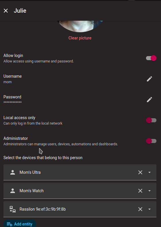

Have you considered “combining” the HA & Owntracks device tracker entities, which might provide a more consistent/accurate location? You can do this with the built-in Person integration. Or, you could try out my Composite custom integration (which actually has existed since before the Person integration was created.) Either way, you’d use the resultant entity in your automations instead of the HA or Owntracks device tracker entities.
