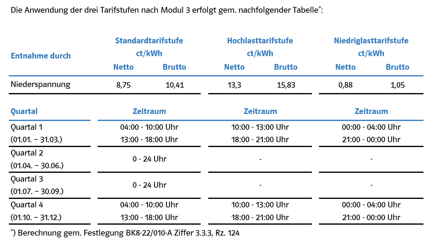

in Germany we are facing the challenge of Netzentgelte being “flexible” (time-based for now) based on a law so called §14a EnWG. Multiple options are available, but I’m targeting Module 1 / Module 3 setup which leads to the following table:
These depends on your grid provider, in this case it is SH Netz and taken from the “Preisblatt Netzentgelte Strom”. Any other grid provider needs to publish similar details.
To use the different tariffs in automations or just for visibility I created the following two template sensors:
    - name: "Aktueller Tarif"
      unique_id: "aktueller_tarif"
      state: >-
        {% set m = now().month %}
        {% set h = now().hour %}
        {% if m in [4,5,6,7,8,9] %}
          Standardtarif
        {% else %}
          {% if h < 4 %}
            Niedriglasttarif
          {% elif h < 10 %}
            Standardtarif
          {% elif h < 13 %}
            Hochlasttarif
          {% elif h < 18 %}
            Standardtarif
          {% elif h < 21 %}
            Hochlasttarif
          {% else %}
            Niedriglasttarif
          {% endif %}
        {% endif %}
    # Netzentgelte Sensor (Netto)
    - name: "Aktuelle Netzentgelte (Netto)"
      unique_id: "aktuelle_netzentgelte_netto"
      unit_of_measurement: "ct/kWh"
      state: >-
        {% set tarif = states('sensor.aktueller_tarif') %}
        {% if tarif == 'Niedriglasttarif' %}
          0.88
        {% elif tarif == 'Standardtarif' %}
          8.75
        {% elif tarif == 'Hochlasttarif' %}
          13.3
        {% else %}
          unknown
        {% endif %}
First one is determining the current tariff out of the three options based on month of the year followed by checking the individual hours of the day.
The second sensor is taking the output of the first to provide a net price in ct/kWh. Having the second sensor based on the first allows easier updates in case the values change.

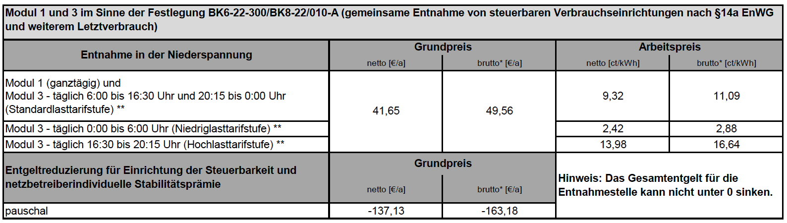

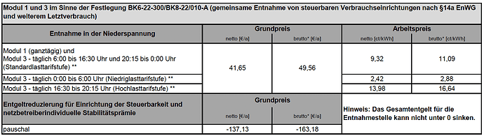

Habe das für meine Zwecke nochmal modifiziert für die Tabelle der regionetz Aachen und auf meinen aktuellen Arbeitspreis umgerechnet.
template:
  - sensor:
        unique_id: "aktueller_tarif_regionetz"
        state: >-
          {% set m = now().hour * 60 + now().minute %}
          {% if m < 360 %}
            Niedriglasttarif
          {% elif m < 990 %}
            Standardtarif
          {% elif m < 1215 %}
            Hochlasttarif
          {% else %}
            Standardtarif
          {% endif %}
      - name: "Aktueller Strompreis"
        unique_id: "aktueller_strompreis_regionetz"
        device_class: monetary
        state: >-
          {% set basis_ohne_netz = 29.10 - 9.32 %}
            {{ (basis_ohne_netz + 2.42) | round(2) }}
            {{ (basis_ohne_netz + 9.32) | round(2) }}
            {{ (basis_ohne_netz + 13.98) | round(2) }}
          {% else %}
            {{ 29.10 }}
          {% endif %}
