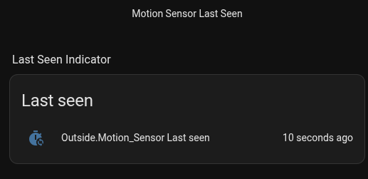

Just for fun, I created a dashboard to display the value:
Sorry to be pedantic, but HA YAML baffles me no end.
How in the world do I trigger something based upon this sensor > 5 minutes?
And yes, I will get a cover, but for now the engineer in me wants to make this work.
Thank you
