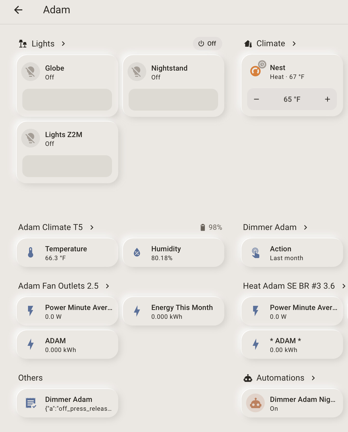

In the Overview dashboard, the dimmer in Adam’s room shows like this:

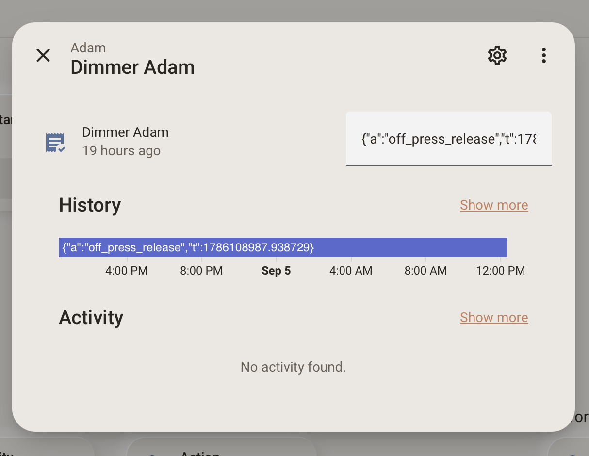

Clicking it just gets the ‘more info’ dialog.
