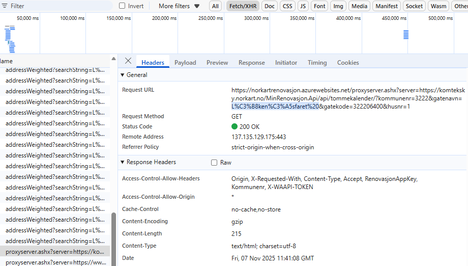

Some information is required to make the API call. Open developer tools in your browser and go to the Network tab. Navigate to ROAF Hentekalender and enter the address you wish to get the garbage collection days for. In the Network tab you will find a bunch of requests to proxyserver... click on the first of these.
In the request url you will find the following
  • kommunenr
  • gatenavn
  • gatekode
  • husnr
In the header you will find
  • renovasjonappkey
This information is needed as input for the blueprint to work.

My address has an ø and å in it, maybe that is an issue?
Can you try it with another address, one without øæå?
Edit:
I did a test now with a random address with special characters: “Løkenåsfaret 1”.
In the request URL this is translated to: “L%C3%B8ken%C3%A5sfaret%20”. This is what you have to use as input to the blueprint, then it should work.
