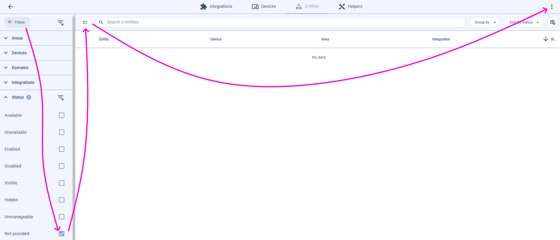

Go to Settings → Devices & Services → Entities List.
Using button the top left filter by “Not provided”.
Delete the entities in bulk by selecting them and using the three dots menu.
@tom_l I wish it was that simple, none of the Shelly entities of the deleted devices (that can be found in core.device_registry and core.entity_registry ) are shown there.

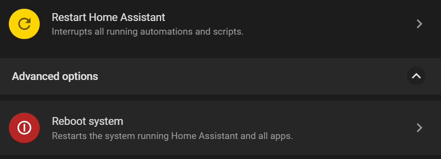

edit3: Huh, instead of issuing the restart command through SSH (like I always do when replacing the Let’s Encrypt certificate) I did this in the VM, now it seems to work?!
Restart in HA does a restart. VM does a reboot.
They’re 2 different things & I’m guessing db changes require a full reboot.
@ShadowFist Woops, I meant stop, tried to do ha core stop using SSH, then clean up the files and then ha core start, while after SCP’ing a new Lets Encrypt certificate I always have a script do ha core restart.
