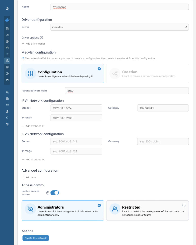

All this can be graphically setup in portainer under network section.
Then just put the homeassistant docker container from host network to macvlanname network.
Just do your test before going to production but it should work.

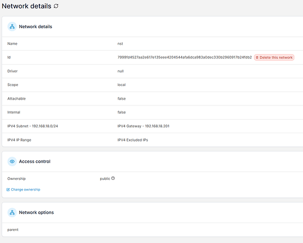

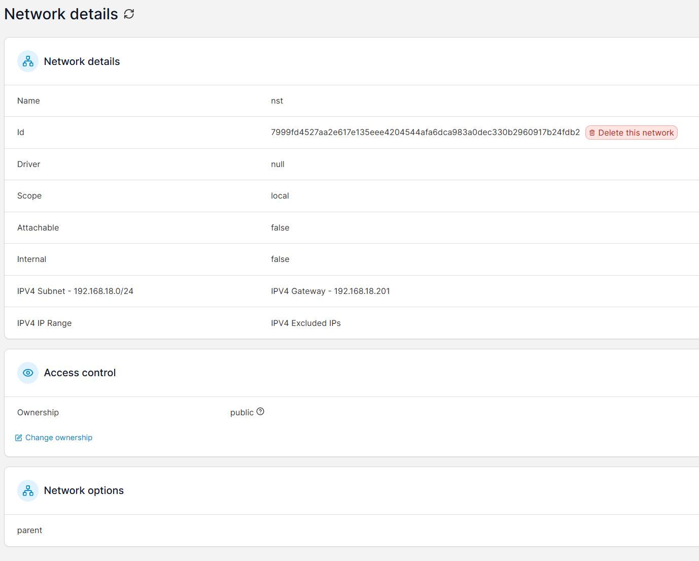

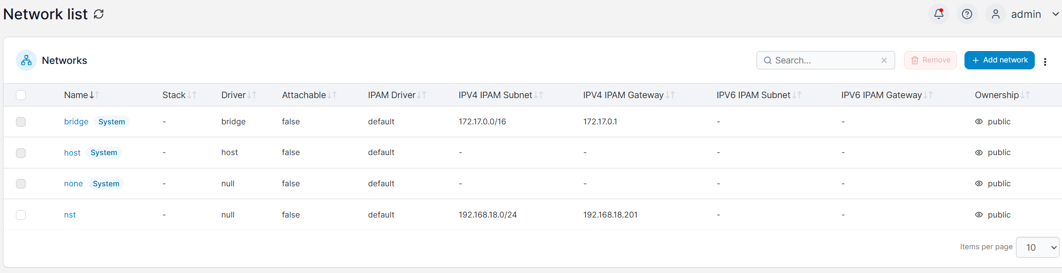

thanks. I am new for the protainer. have protainer installed. Will try.
After create network. I can’t deploy container with new network when set static ip. the error message is "
Failed starting container: user specified IP address is supported on user defined networks only".
ok it might have something to do with the network not being created or being created twice, not sure.
Sincerely with the screenshot I am a bit lost.

Sorry but the screenshots were unclear to me.
