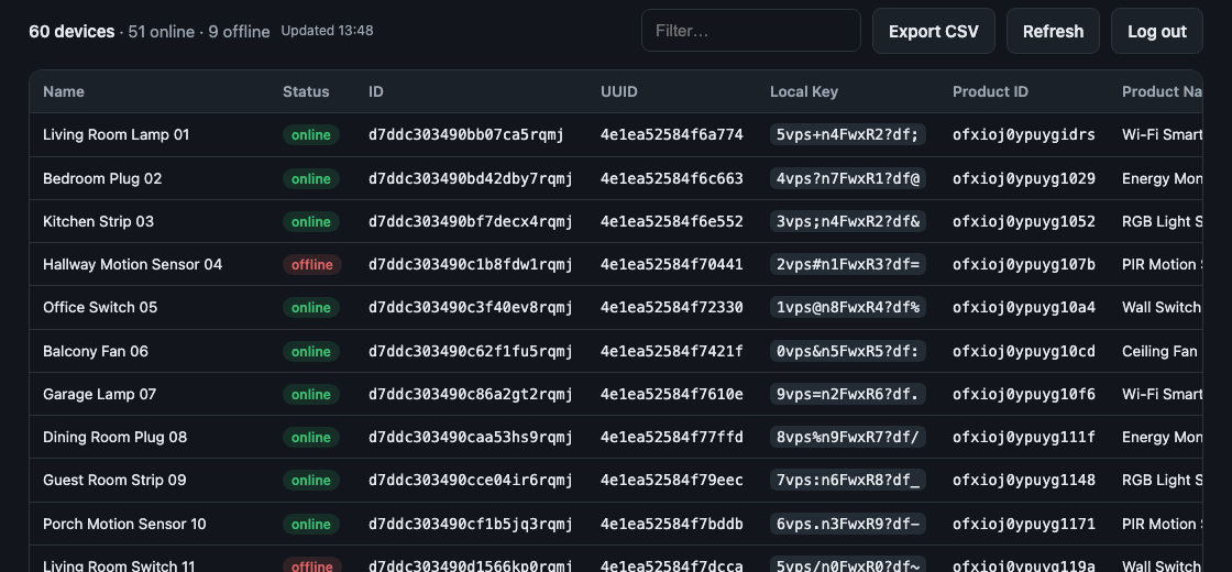

I built a small tool to solve a problem I’ve run into a few times with local tuya integration.
Most local tuya integrations can fetch the local key during the initial setup. But if you factory reset a device and pair it again, the local key changes. Your device stops working in Home Assistant, and all you really need is the new local key.
To get the latest local key, you have to go through the Tuya IoT Developer Portal. This tool skips that completely.
Just enter your Smart Life or Tuya Smart User Code, then scan the generated QR code. That’s it. It will list all the devices in your account along with their Local Key , Device ID , Device Name and more. The login session is cached, so you don’t need to scan the QR code every time.

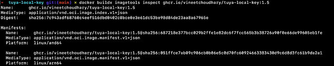

Could you let me know which CPU architecture your Home Assistant is running on? It looks like it is fetching the unknown/unknown build (multi-platform build manifest) instead of a platform-specific image. Right now it only supports amd64 and arm64.
I get the same error as @Remco_van_Geel. Running HAOS 18.0 on Proxmox
Proxmox should definitely be amd64 . I’ll investigate and see if I can remove the unknown/unknown manifest.

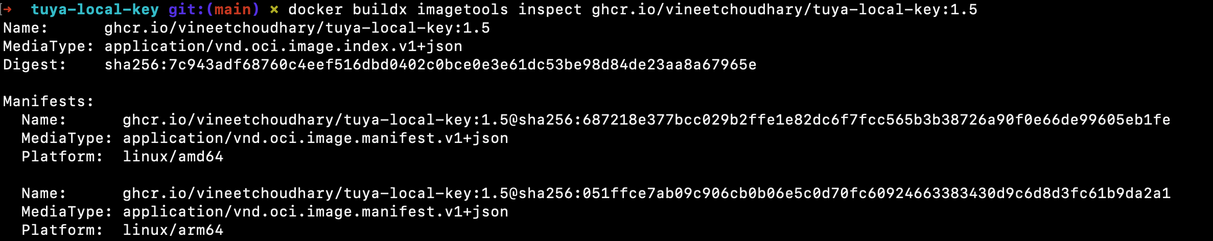

@Remco_van_Geel @Holdestmade could you please try again with version 1.5, where I’ve disabled the provenance and SBOM image attestations?
GHCR images no longer contains any manifests with the unknown/unknown OS/architecture. Please make sure you’re pulling the 1.5 image.
Yes, that worked.
