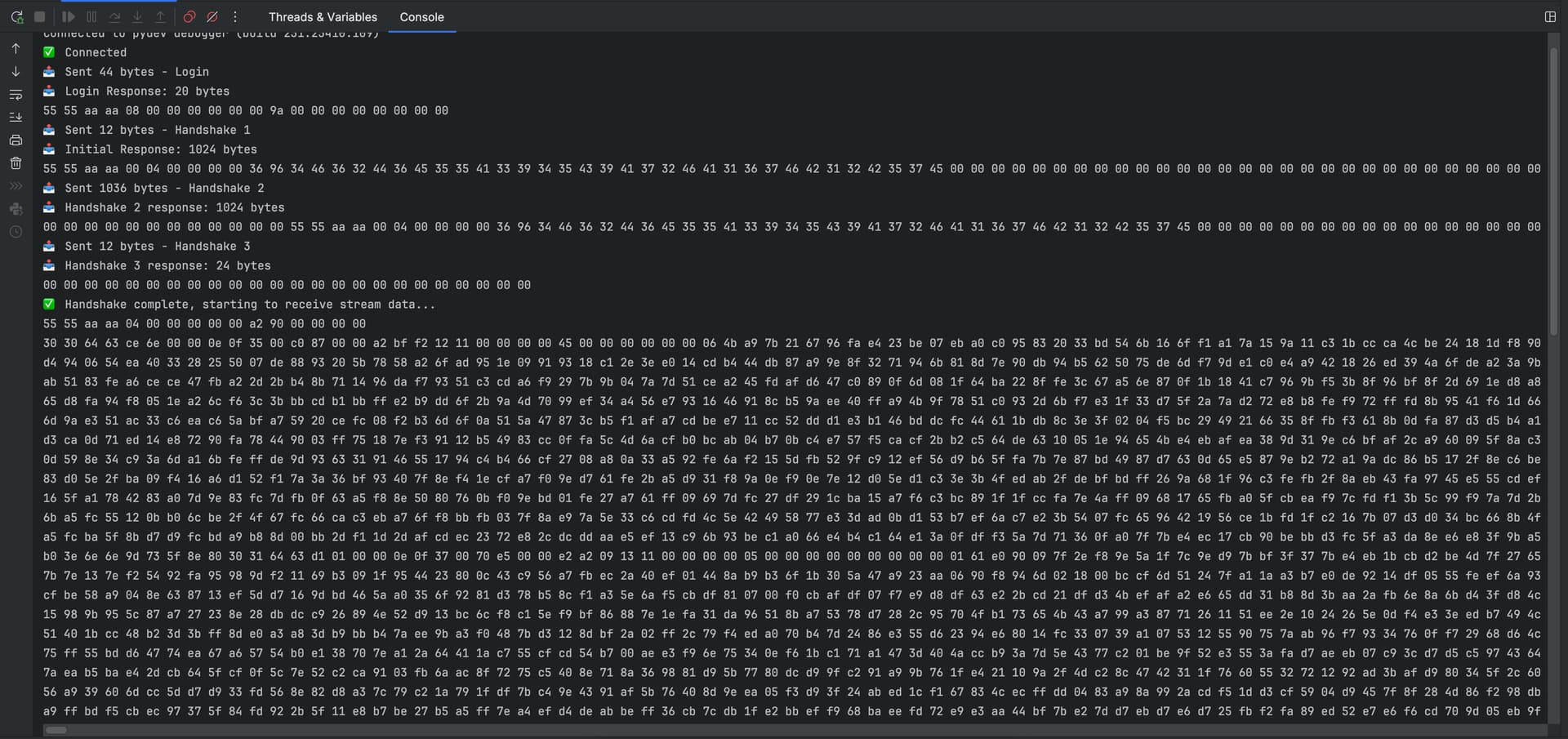

I started re-writing the code in Python. With help from Wireshark and ChatGPT, I am now able to read the stream directly from the cameras. Below is my rough code for one camera. You will notice that I have some hardcoded Hex values. With Wireshark and Zviewer, I discovered that all my cameras are actually accessible directly in the local network. I also discovered that all cameras are using Username: admin and Password: 111111 if you have not set one for them. So you can hardcode that in the hex. I basically copied the values from Wirshark and it worked!! I also scanned the NVR and Cameras IP addresses for opened ports and found mine only has 8000 opened. So, this is also hardcoded for now.

I have created two methods to handle the received stream. One for storing it to file and one for piping it to a FIFO pipe so another service can consume it. I have one issue which I would like to get help with. The stream coming from the camera is encoded for Zmodo and I am not able to play it back using FFMPEG. I would love to get help here if possible.

Just pasting the output from the script so far:

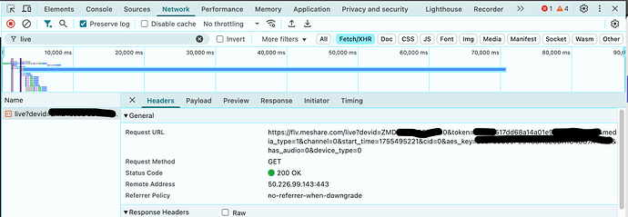

However, I have implemented the following solution which I found on this forum but I could not get to work out of the box (Zmodo Cloud (non-NVR)). But here it is slightly modified and working. See steps below. This will depend on your upload and download speed. I have good internet so it is working well for me.

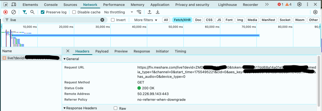

  1. Login to Zmodo web interface: https://user.zmodo.com/. Use your username and passwords then go to the list of cameras and click on one of them.
  2. Right click on the browser and click on inspect (or F12).
  3. Go to Network and Filter requests by Fetch/XHR
  4. Get the token like below
  5. In configuration.yaml, store the initial token in a cookie in HA (NOTE: your need to update it here if it ever expires by re-login). you will also need and the DevID and AES Key for each camera for Step 8.

  1. Create camera controllers in HA in configuration.yaml. The annoying :unamused: thing here is that you cannot set the value of these parameters at the top of the configuration. You will need to explicitly have them in the URLs.
camera:
  - platform: ffmpeg
    input: >-
      https://flv.meshare.com/live?devid=ZMD*********&token=****87**********5f4d&media_type=2&aes_key=095*********BAC1
  - platform: ffmpeg
    input: >-
      https://flv.meshare.com/live?devid=ZMD*********&token=****87**********5f4d&media_type=2&aes_key=AB1*******79B1
more cameras

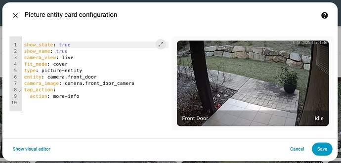

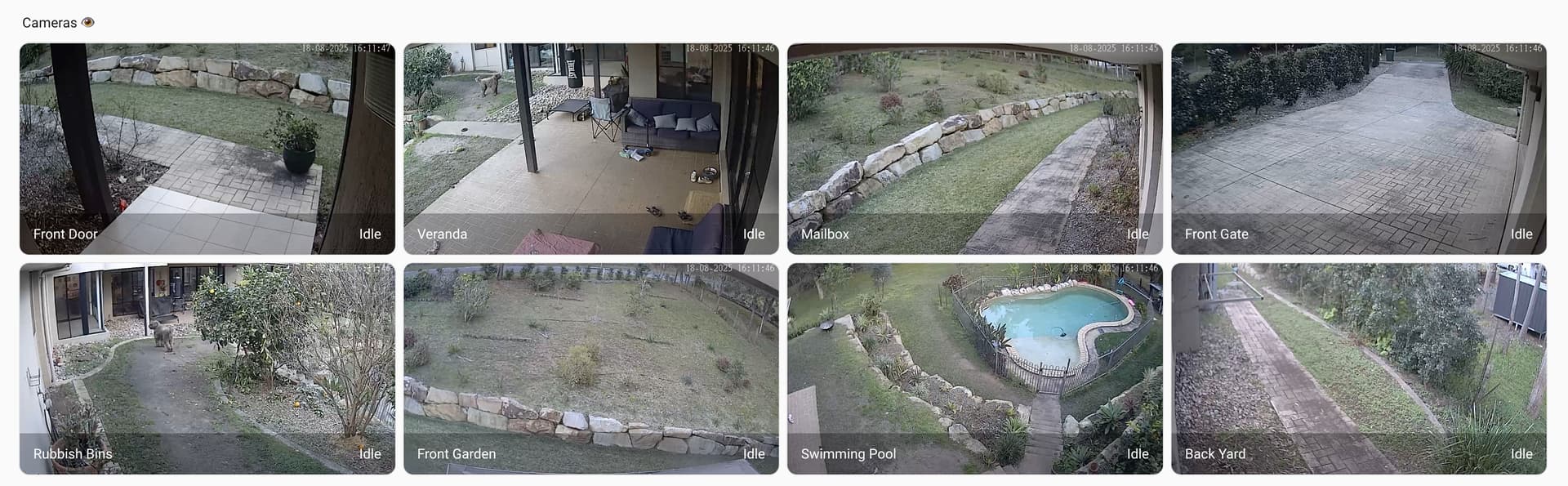

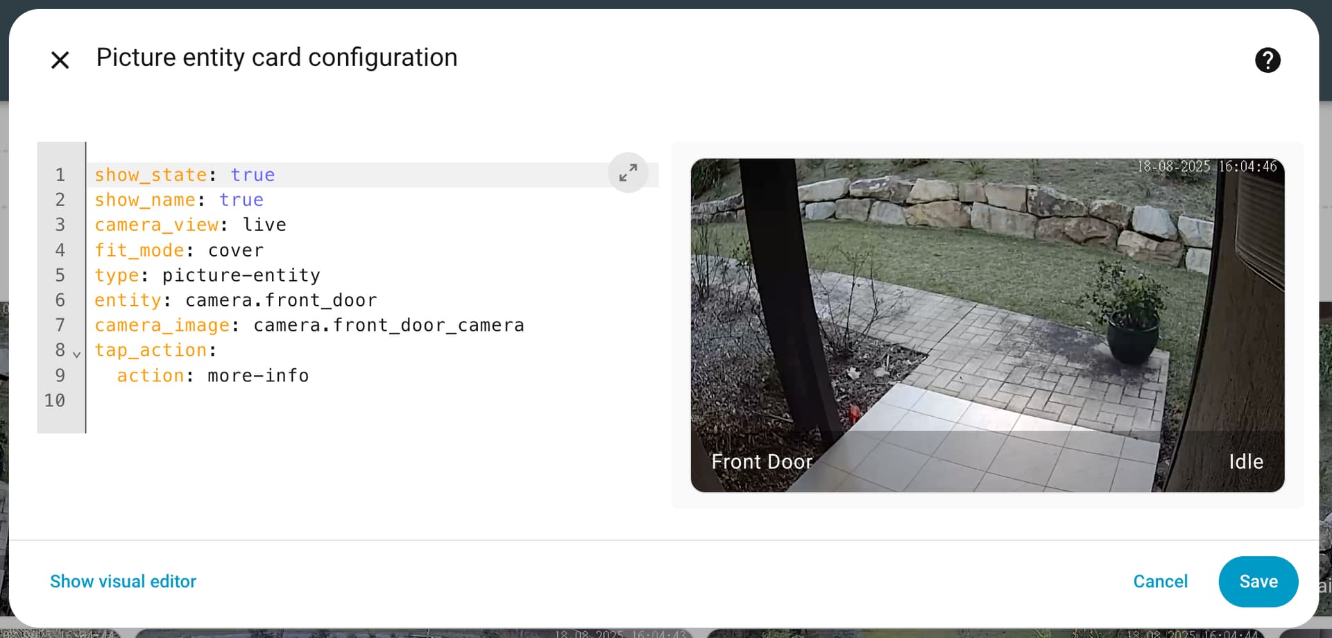

  1. Now add your cameras to your dashboard
show_state: true
show_name: true
camera_view: live
fit_mode: cover
type: picture-entity
entity: camera.front_door
camera_image: camera.front_door_camera
tap_action:
  action: more-info
  1. Enjoy! :grinning:

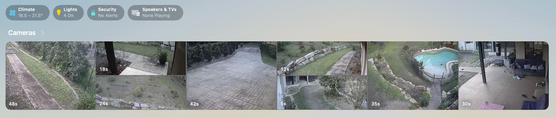

Bonus!
If you have Homekit Bridge setup you can view the cameras from your HomeKit App on Mac, iPhone and iPad.
Nice work! I created the other guide, but my latest comment says that the initial guide is now wrong because they changed all their API’s!
And, it is no longer necessary to do the https://user.zmodo.com/api/refresh?tokenid as that endpoint does not exist anymore.
Just grab the URL as you did, and paste it into the ffmpeg camera. It will automatically take a screenshot every 10 seconds and works well. I set my camera up on August 6, 2025, and my two cameras are still working without any token refresh (but this is because of the ffmpeg camera always doing something with the stream).
