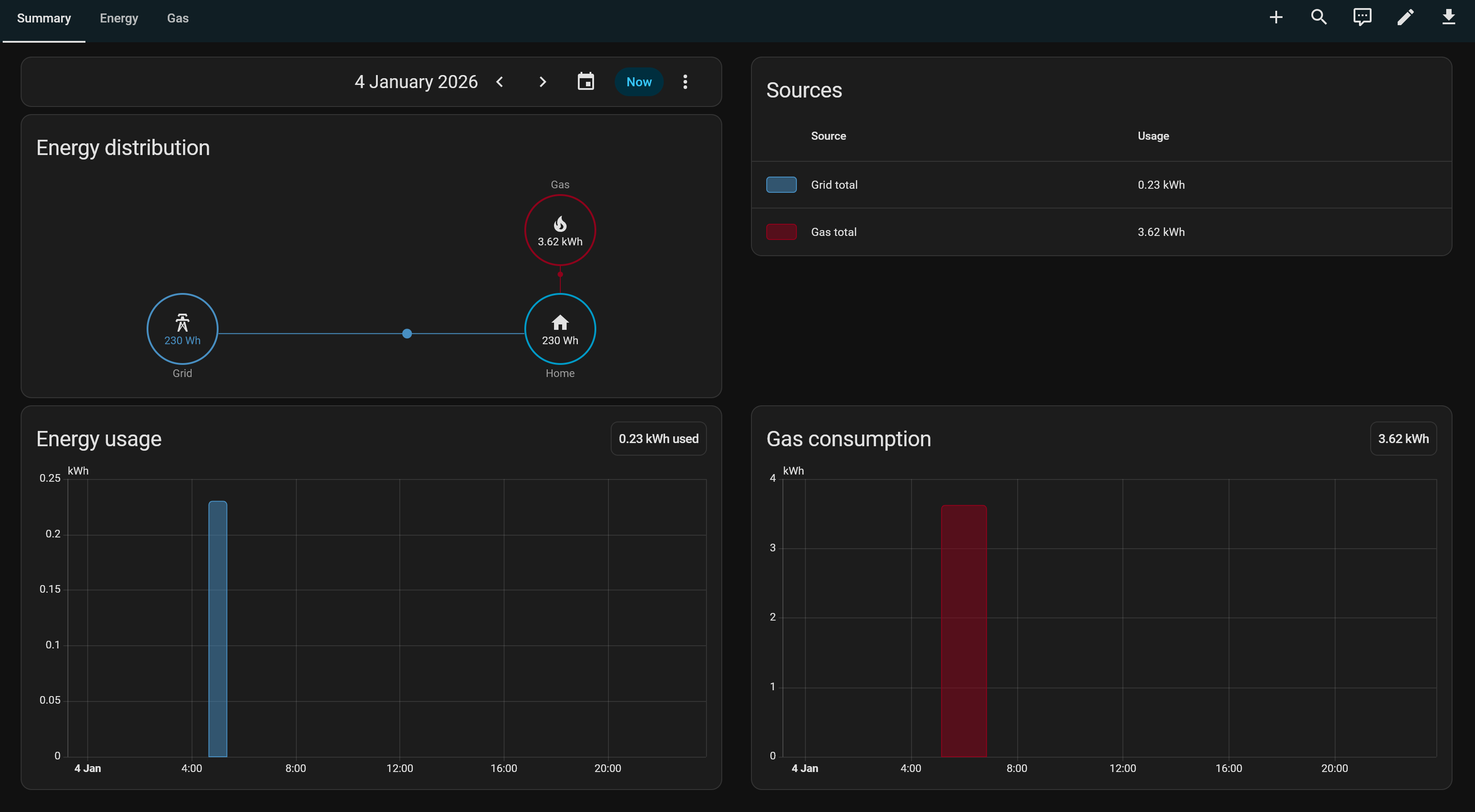

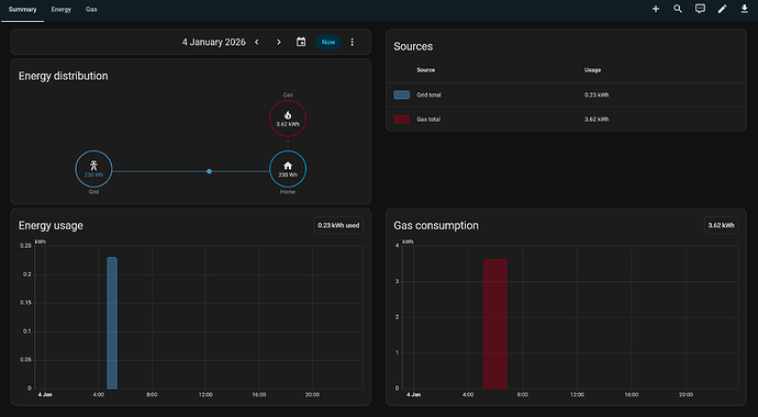

Well, it has been 3 Days since I set this up and I have very limited Stats as seen here:
Any suggestions?

Sorry I got caught up with the holidays.
Did you get sorted with the data?
Mine does populate but it appears to record at random times.
Hello
The Data seems to be few and far between, unfortunately :frowning:
Also, when it does come through it does not seem to line up with the Data shown in the Bright App which seems weird to me.

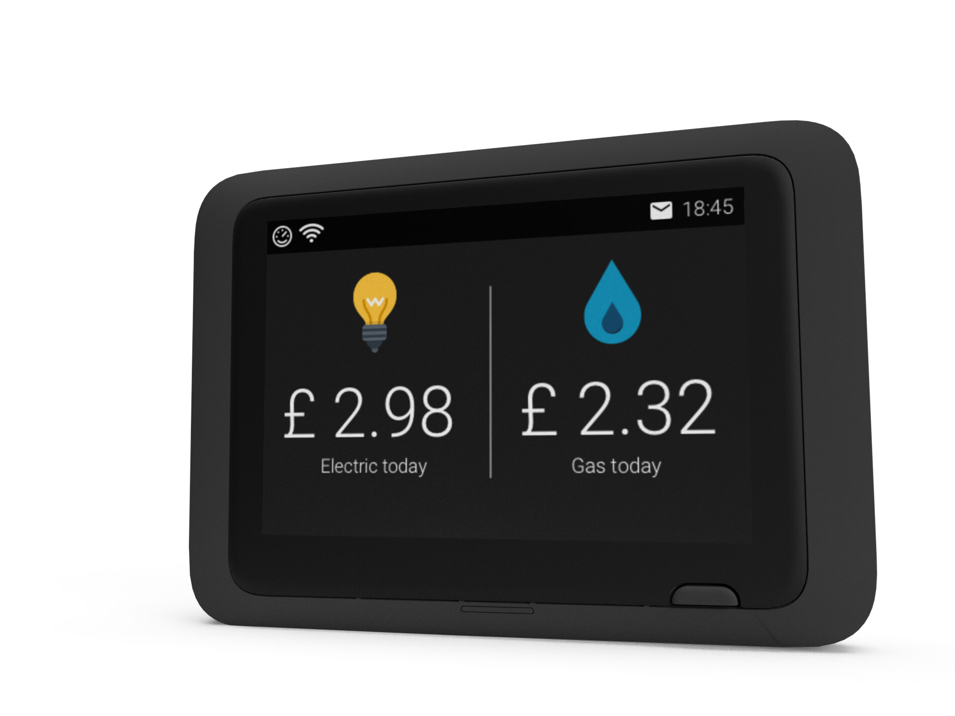

I tried for ages to get the Bright App working with the DCC integration with sketchy random data.
I bought a Hildebrand Glow CAD and its worked perfectly since, uses MQTT and there is a custom component in HA for it
They also do a wired one if you don’t need the display but they only have 160 left:

I have Ordered a Wired Unit as I do not need the Display.
Is there anything I need to do in order to implement it in Home Assistant, apart from Adding it as a Zigbee Device?
Thanks in advance
Kevin
It doesn’t work with ZigBee to HA. It used a proprietary ZigBee connection to the meters and sends data to HA via MQTT. you’ll need to setup up MQTT on HA if you haven’t already and install the custom component:

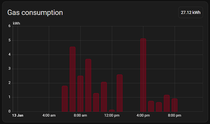

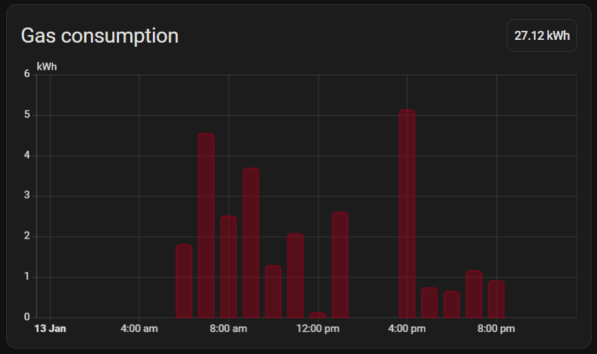

I have noticed that the Energy Dashboard seems to only be Updating at 12 Minutes Past the Hour so it not showing Realtime, or near to, Data.
Is there anyway to get the Realtime Data to be shown in Home Assistant?
I have tried Creating my own Energy Dashboard, no easy task, I am still learning, however, the new Dashboard has the same behaviour, Updaing once an Hour at 12 Minutes Past the Hour.
Any suggestions?
Thanks in advance
Kevin
The energy in the energy dashboard does only update every hour or so. The CAD does have realtime data. If you want realtime data, you can show the entities on a custom dashboard.

I have tried Creating a New Dashboard but it is stiill only Updating every Hour, or so…
On the New Dashboard I am using the ‘Statistics Graph’ Card, one for Electricity and another for Gas, is that the Correct Card to use?
Thanks in advance
Kevin
Just looked at my energy dashboard and the Power Sources Graph updates every 5 minutes. What entities are you using ?
